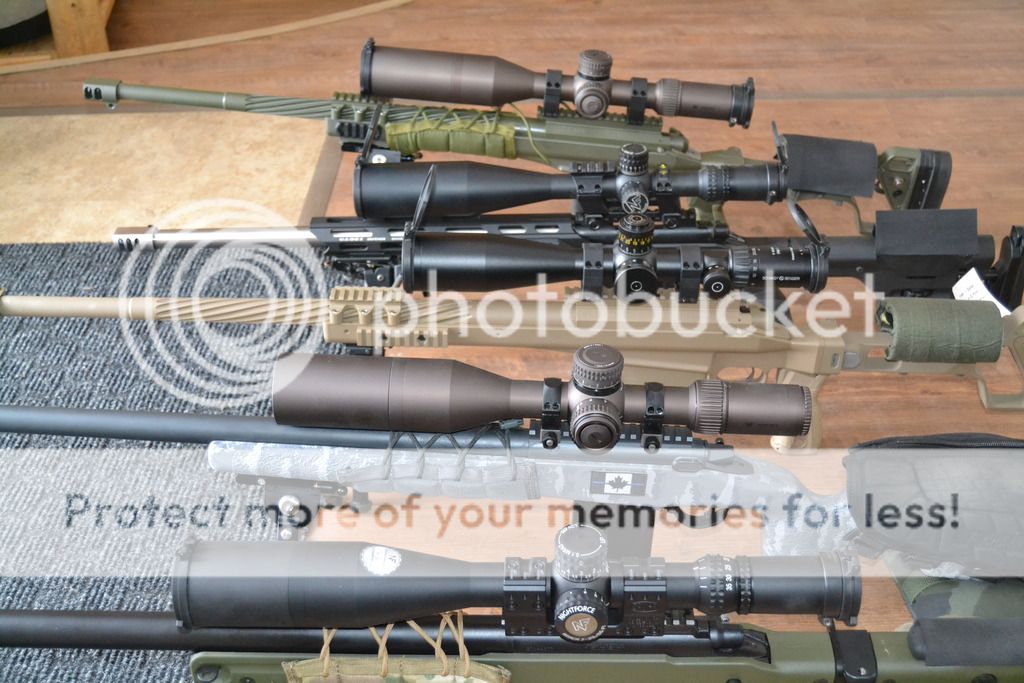

The last piece of the shooting system boils down to the choice of glass - over the past year I have been engaged in a process of upgrading my scopes from SFP MOA/MOA to FFP MIL/MIL - and so I have a number of quite new and very nice scopes to hand. Initially and as can be see in the pictures that accompany this article I mounted the latest NF ATACR F1 in 7-35x56 using a SPHUR 34mm mount. This scope - which it would be an understatement to describe as really rather nice - will be the subject of my next review during which I will compare it to the classic S+B Pmii 5-25x56 and the current favorite amongst PRS shooters; the Vortex Razor HD Gen II 4.5-27x56.
