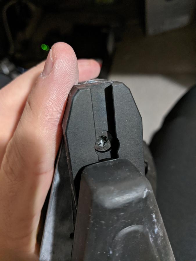

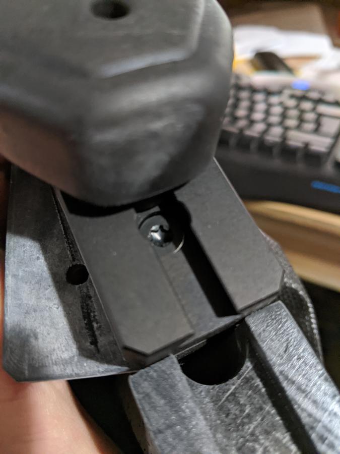

I do need help to adjust the length of pull. Pulled a bunch of screws out and none of them was right. Need a T25 slim shank to try the couple other screws. No Youtube videos or explanation in the "manual"
What he said :confused::confused: ...... same here. Comb height, got it, raise or lower the butt, got it..... have the different size spacers that came in box for extending length of pull but ????? Took out all the screws, pulled pushed pried, nope don’t get it.
There are two screws under the rubber butt plate. They wold be parallel to the bore. Loosen those until enough space is created and then insert the spacer. I will try to attach some pictures.
