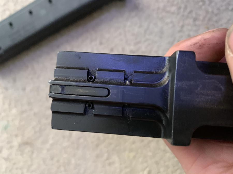

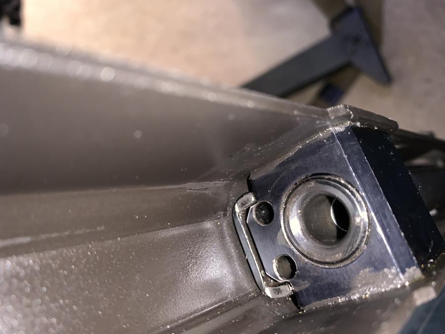

Parts never arrived, so I got frustrated and went ahead and bought some replacement screws for the butt plate. Installed them today, the original screws were in pretty rough shape, a couple were very close to being sheared right off. Especially considering I’ve put no more than 250rds of factory ammo through this rifle. While installing the new screws I noticed some concerning wear and tear in this rifle. The extractor groove is deformed and the plate above the barrel block looks like it’s deformed quite a bit as well. Sent Jard another email complete with pictures to see what they have to say about it, but I’m pretty frustrated with this thing. 250rds! One range trip! Man! I really wanted to like this rifle but so far it’s pretty hard.

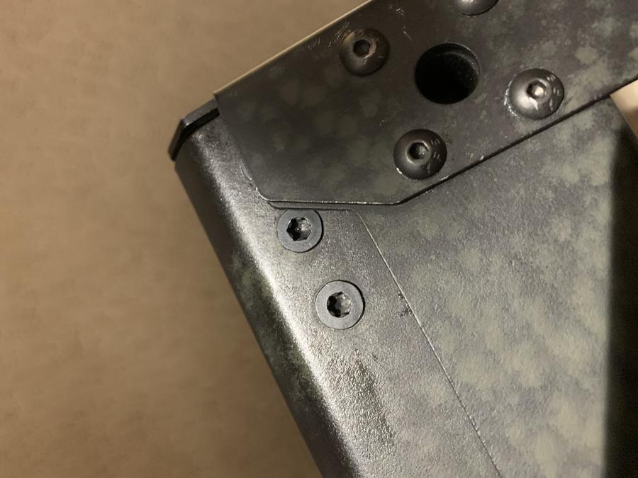

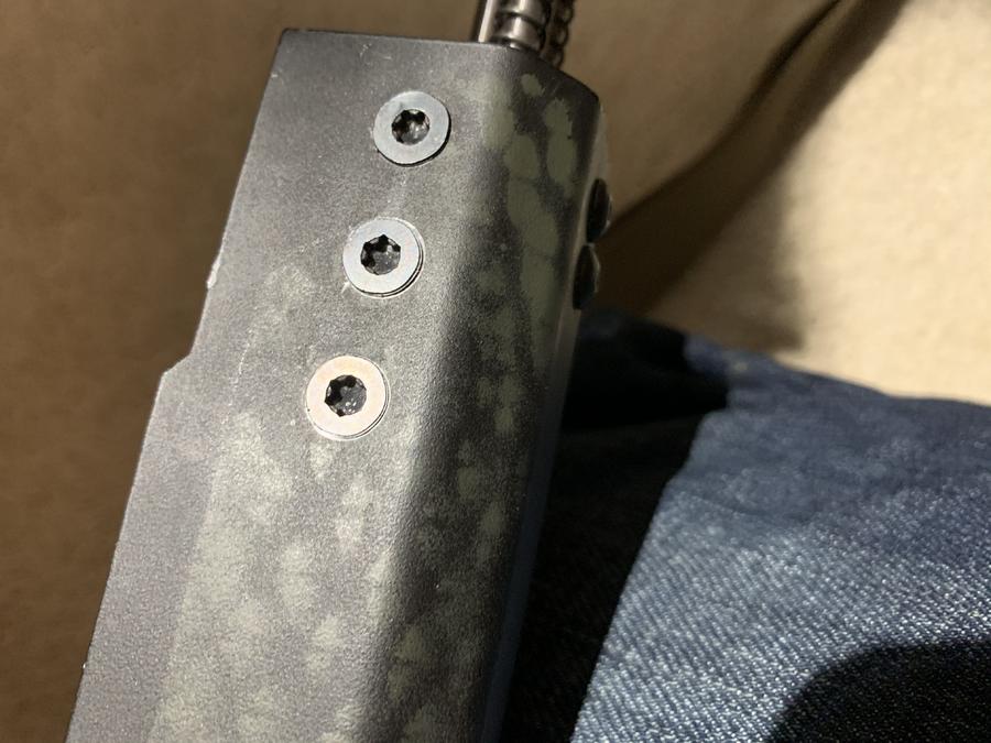

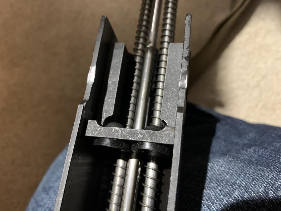

Out of the blue the bolt stop arrived in the mail. Also what looked like a different guide rod rear plate but I couldn’t figure that part out. So I installed it, wasn’t too bad, they sent me a print out to drill the bolt holes. Finally I have a bolt stop. Not sure about the rest of the rifle yet, but I’m going to run it and see how it does. I’ll report back. 92AC34E3-854A-4831-AF87-EEE96A0571E0.jpg7CB0C8A6-9EC9-4012-AE28-6FBE774E8E8A.jpg98B38BC5-898B-4A7F-BC01-364332ED29EE.jpg
