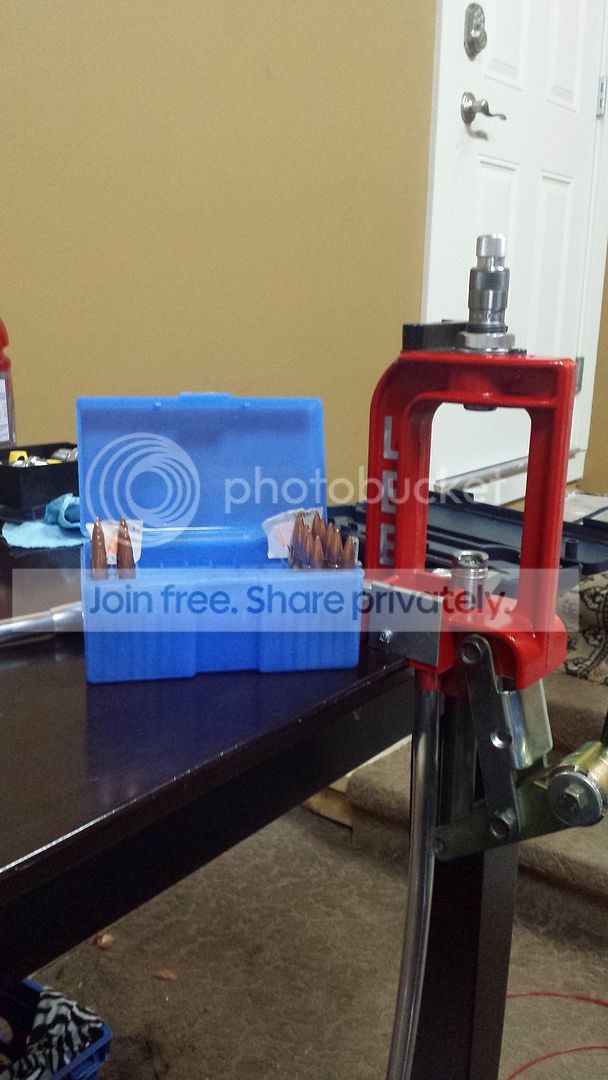

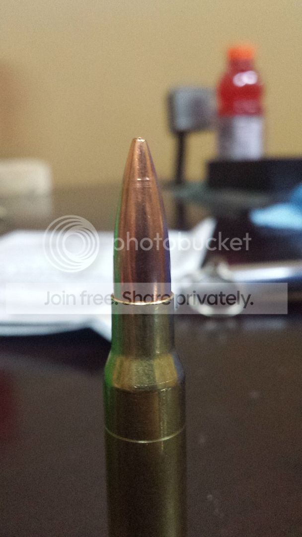

View attachment 33767View attachment 33768View attachment 33769
I too was wondering about the ring below the shoulder that is not normal??
Also why did you load 20 rounds with the same powder charge ?? Normally I would load the first rounds (3 to 5 rds) at a time with different powder charges 42.5 grs 43 gr 43.5 grs 44.grs 44.5 grs Then as you shoot them look for groupings and inspect cases for pressure sighs then load the next rds .2 grs to either side of where you find your best groupings
This recipe was given to me by my rifles original owner, he was in 1/2 moa with the same charge but in lapua brass.
