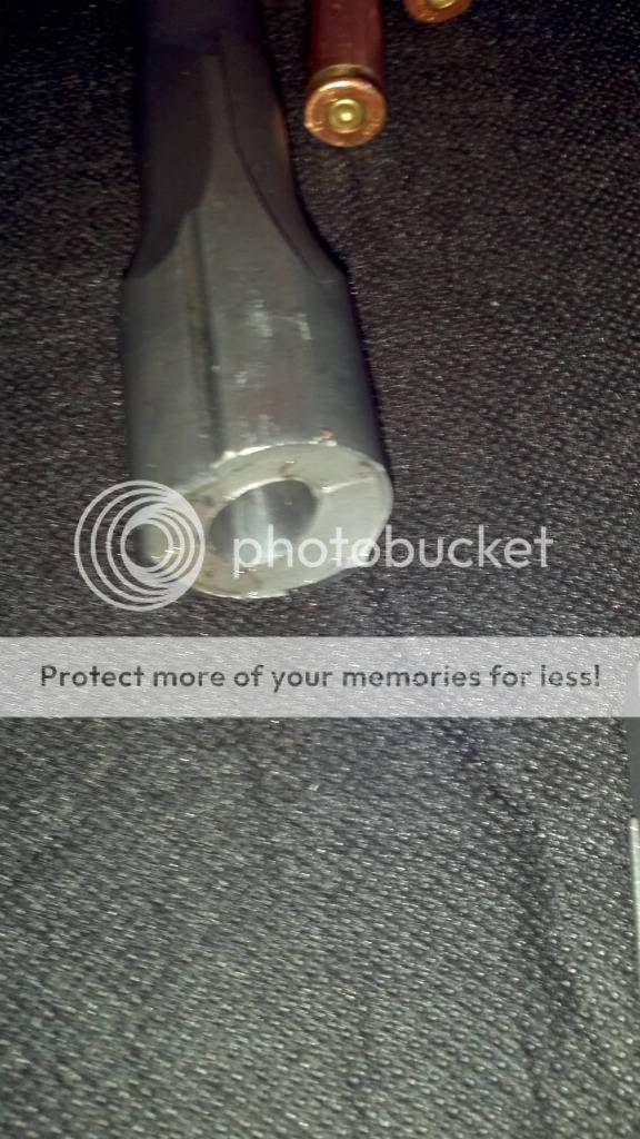

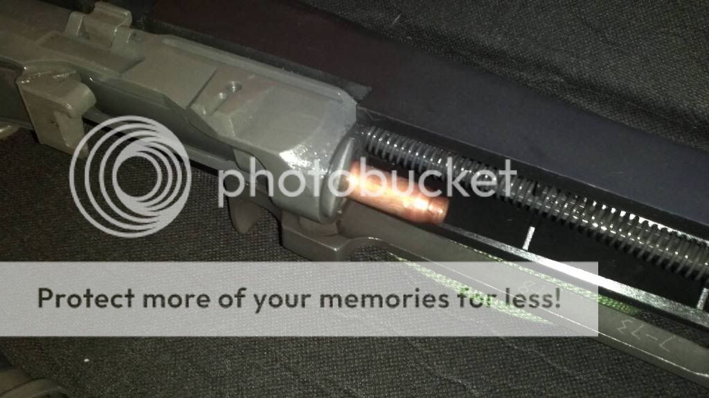

New M-14 range report FAIL
Doesn't SA have any surplus forged receivers and barrels from the 50-60's that can be used? Or did they chop them or donate them to allies? And how many M14's are still around after Clinton had the majority of them destroyed?
Maybe call their consumer relations dept Laugh2
Both Norinco and Polytech Industries receivers are made at the same factory, State Arsenal 356 in Yunnan Province, PRC.
And we all know how concerned the Chinese are about our tiny little complaints .
Glad to see you take this matter seriously. I dont expect to contact Norinco as I realise that this would most likely be a dead end. However, the importers certainly have some contacts over there that they could advise of the problem and expect a response. I dont think they like taking a hit with the returns and dont know if they send them back to Norinco for a refund. Maybe one or two is not worth it, but advising Norinco sure is.d:h:
More BS propaganda. I have 3 and no problems. Keep telling yourself how the Springfields are inferior. I see problematic Norinco threads pop up here all the time. I guess that forged reciever didn't help a whole lot did it?
Practice saying Baaa baaaaa like the rest of the sheep.
+1
I had 3 older Springfield M1A and still have one Loaded and I still very satisfied. They are well fitted, reliable, better value and LIFETIME GUARANTEED (you just have to sent it back to your Canadian dealer) unlike other makes... :)
perhaps you should peruse the U.S. M14 forums for Springfield reviews. There are probably 1000 M-305's here for every Sproingfield. You pay your money and deal with what you have.
Peruse? When using spellcheck be certain the word you select is the correct alternative.
I've read through the M-14 web site forums. I don't claim there have never been any problems. In fact I've kept quite a library of M1A and M14 history.
See below. I take no pleasure in the misfortune of the buyers of Norinco rifles as you should take none in the bad luck of SAI buyers. I realize this is off topic and I'm happy the originator of this thread is ok and glad to hear the distributor is taking the high road here. I have considdered buying a Norinco. But as Hungry says don't buy one buy two. That way you are likely to have a good one.
