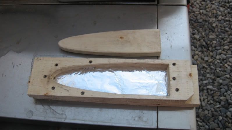

The negative/positive of the piece to be cast.

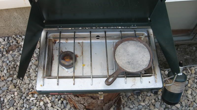

Cookin' up a batch o' lead

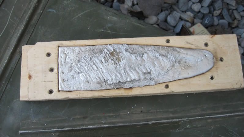

Freshly poured....effen hot that crap is, just ask me how I know!

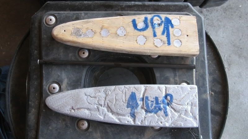

Turned out pretty good. The top one is version 1 not quite heavy enough. The solid insert is version 2. Go big or go home. A few pounds of solid lead never hurt anyone.:D

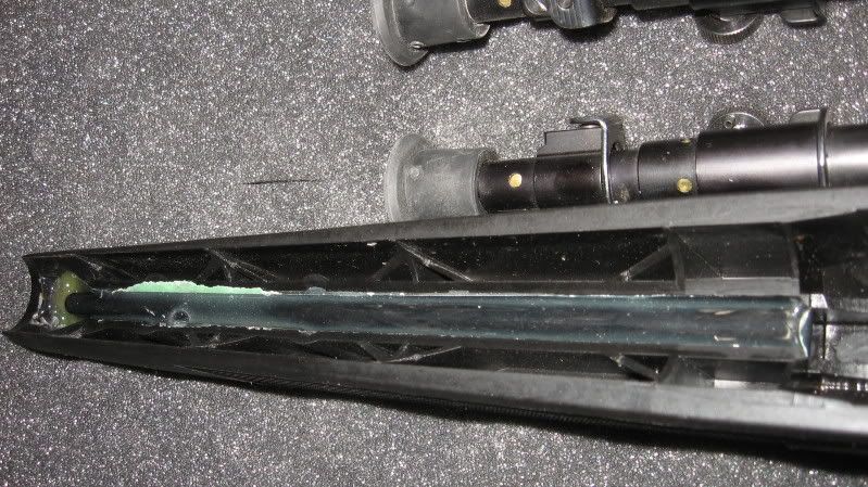

Figured I the forened would be lonley without some tinkering to so I drizzzled some expoxy and embeded a length of an old carbon arrow shaft. Hope she's good and stiff now.
