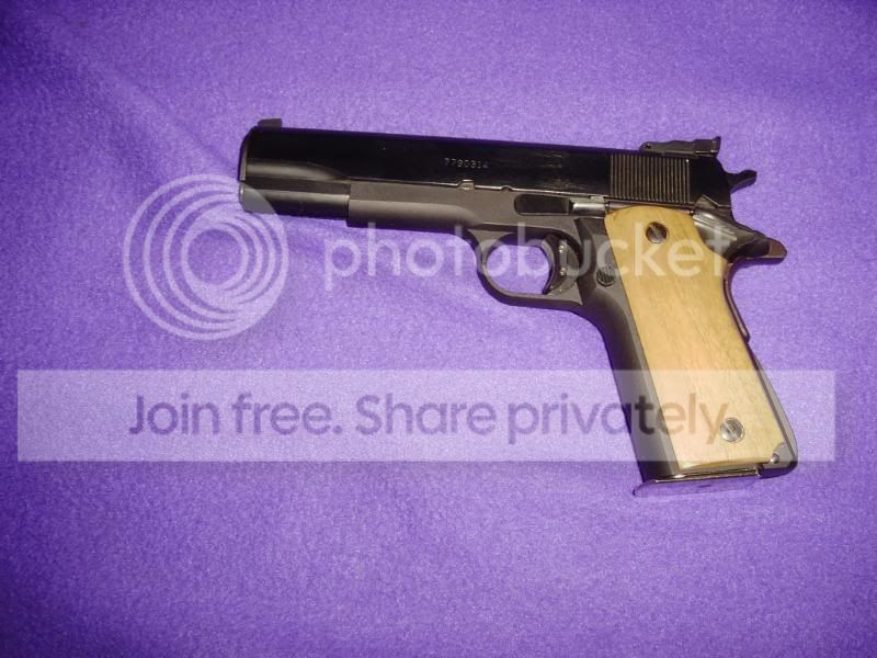

Austen, I love project guns. I went the other route. How so? I traded a 4" Nickel S&W M34 for a Para 14 kit with a WWII Remington slide. I ended up taking the slide off and using a WWII US Government replacement slide on the Para kit frame. The WWII US Government replacement slide has adjustable sights and I also used a Storm Lake barrel from E-Bay. The end result is a tack driver. Regards, Richard:)
These are the Two pistols I ended up with:
Richard, those look pretty nice! Project guns are definitively fun!
