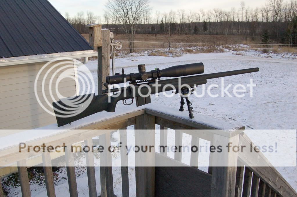

New Precision Rifle in the house!-New pics on post #52!

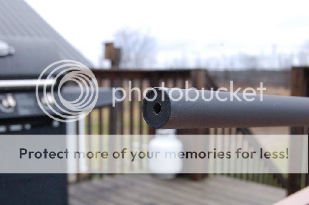

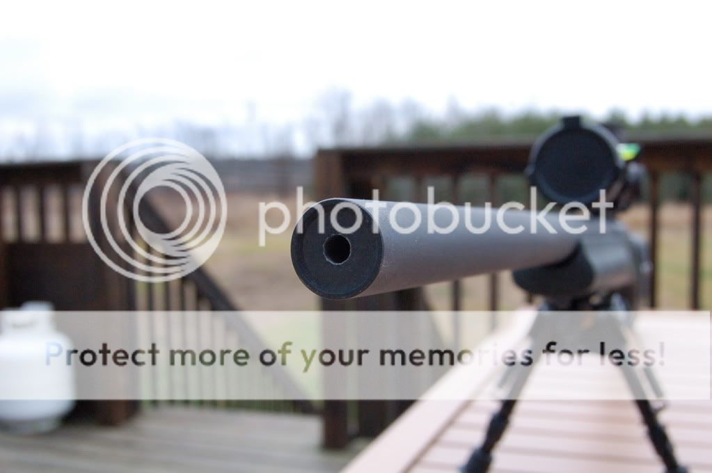

Still waiting for a picture of the recessed crown. Your Rifle looks very nice. I am loading 48gr of h4831sc in my 260 with 142 gr. matchkings. The bullets are sitting .001" off of the lands. I am using Nosler brass though. One day I'll move into the Lapua brass.

Sorry, I forgot about the picture request for the recessed crown. I do not know what the standard is, but this is how mine was done...

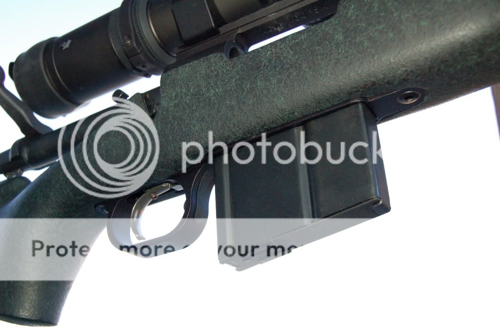

Wyatt Bottom Metal installed!
I have upgraded my mag system to a detachable mag and bottom metal from Wyatt. The bottom metal is machined aluminum with the mag release similar to a factory Remington found in the front of the trigger gaurd bow. The mags are metal, and seem to be very robust, however I do not have any experience with this type of mag system from any manufacturer so it is hard for me to comment on the quality in comparison to other brands available, but for a green horn, these mags seem to be of very high quality, and for what I want to do with the rifle I can forsee no problems at all. They are a centre feed design, with the rounds slightly staggered to the right and left once more rounds are pushed down on top. I got both a 5 round mag and a 10 round mag. I loaded both with ammo, and the spring tension is quite strong, they cycled very well in my rifle with out a hitch, and I tried both of them several times. I did however have to put a small spacer between the stock and the bottom metal at the rear action screw to get proper engagement of the mags to get them to click into place. I am going to experiment a bit more with this to see if there is a better solution.
The thing I like best about this system is the fact it is a drop in fit to my factory inletting on my HS stock. I mean there was no work required to get it to fit in the existing inletting. Other than needing a small spacer as described above, I would call it a perfect fit! I got this kit from Sean at North Shore Barrels, I believe he has several kits available so contact him if you are in need of a new mag system for your rifle!
Here are a few pics to see...
That mag system looks great. How does putting your ammo in a magazine affect the accuracy of the ammo? With very little neck tension on match ammo, does the magazine distort the concentricity when being loaded into the magazine?
That looks really good! What's the internal dimensions of the mag, max length?
The 5 rounder is 2.883", and the 10 rounder is 2.889".
That is a question I can not answer as I do not have any way to check that at this point. Maybe sometime in the new year I will get a case concentricity gauge and I will let you know.
