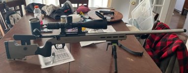

Well finished my 30-06 project. Had an old Remington 700 with a rusted out barrel so I decided to have some fun. After removing the barrel is sent to action to get refinished at Black Box Custom. They did an amazing job and first class customer service. Then i ordered a 26" MTU profile barrel in 1:9 twist and match chamber from JC Custom, again first class service. Added a trigger tech diamond trigger and dropped everything in an MDT Field chassis. Just missing a muzzle break and a good glass and ring. Currently just dropped my Discovery ED glass on it right now. the rings shown have been replaced for low ones. Now to go to the range and test that beast out. plan is to work up a load with 178gr ELD or heavier.
