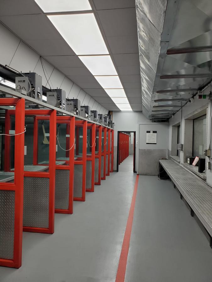

Holy necro thread....
What's interesting is that during the COVID shut down, we actually did another upgrade to the HVAC, completely replacing the duct work, sealing up the bays better and re-balancing. The difference is very noticeable.
And yes... it is a normal piece of equipment that is repairable by any qualified HVAC tech.
