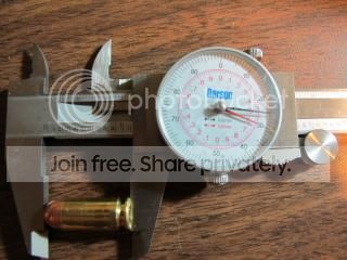

Would the empty space in the case change much if I used the same OAL (1.125") between a 180gn RN and TC bullet?? Would it matter much in regards to case pressure?

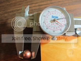

I crimped to .419" dia. They will not fit in the test gauge with out this crimp. Double checked about 15 empty rounds in the gauge and barrel and they seat without dragging.

you might be a bit heavy on the crimp. The plated bullets are softer than jacketed and you don't want to crimp so much that you under size the bullet for your barrel.
Pull a bullet and check the diameter. If you can feel a ring you are probably too heavy. If you measure less than. 401 you may have some accuracy impacts. They will likely cycle fine but may not group very well. I believe the SAMMI max is. 423 for 40 S&W.
As far as CAOL goes you need to figure out what works best for your magazine and pistol combination. I would suggest you figure that out first. I would not go below the published COAL you may be able to go a little longer as long as you magazine and barrel function reliably.

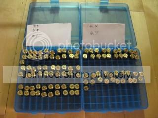

You will need and want to work up the load though. Starting at the 4.2, load 5(a mag load for a rifle) and go up by .1 to the max load of 4.7. Keep em' separate. Factory boxes are good for that. Then go shooting, off a solid rest, at 25 yards, for a group only. When you have a group, you adjust the sights and go practice drawing and dry firing for sight picture and trigger control.

I would agree that the barrel removed from the pistol is a good check for sizing.
I would disagree that all 180 grain are equal. I just measured a Cam-pro 180 TC and the bullet length is.578 measure a Berry's 180 RN and the length is. 597. Since both bullets have a flat bottom is you load them to the same COAL the RN load has. 02 more bullet in the case. If you load the same amount of powder the RN round is likely to be a higher pressure loading due to the reduced case capacity. Not all bullets are the same for a given weight! The profile makes a difference!! Space in the case is very important. A little bullet setback can ruin your day. My 40 loads have a bit of a waist where you can actually be see where the bullet points ends in the case. From what I have read the waist is what helps prevent bullet setback. The crimp plays a minor roll in preventing setback in auto pistol cartridges.

yes there are differences between various bullets of the same weight, but if you seat them with the longest OAL that will reliable feed and fit your mag/chamber and use the starting load you likely won't have issues.
An OAL of 1.125" is what i use. I have a number of pistols and that size seems to work well in all of them.

If this is your first loading attempt, I suggest you load 20 of 3.5, 3.8, 4.1, 4.4 & 4.8
Most of my pistols are best with 3.5 or 3.8. Start low and work up. Find out what shoots most accurately and cycles the action.

With a few rejected loads that I caught with double checking everything, it took a long time to put out 100 rounds. With stopping and measuring everything meant that the progress was slow and messing up one thing would affect another on a progressive press.

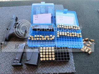

I went to the range on Saturday and had a great day. Here is what I started with:
What I was familiar with was shooting the 180gn Speer Lawman, so I took a few boxes of that to the range. I wanted to do a back-to-back comparison to what I was used to vs the new loads. I shot 1 mag of Lawman then 1 mag of the reloads starting at the weakest load and continued alternating.
The M&P felt like a totally different pistol. Sounded like everyone else's gun at the range (most of them shoot 9mm) that I routinely shoot with. Recoil was more manageable, with much less dipping with my flinching. The groups were meh but they never went below the horizontal point of what I was aiming at (I frequently shoot at 8 o'clock if I lose focus) .
As I got closer to the max load, the recoil got increased, but nowhere near the Lawman's and still more comfortable to shoot. My forearms aren't as sore today as after a regular shooting session. I ended up shooting the remaining Lawman at some steel, which was fun. Overall, shot 100 reloads with perfect cycling without any FTF, FTE, and another 250 Lawman. Comparison of the casings seems that the Lawman is more cleaner-burning than the Tightgroup. The end of the barrel has more soot too. Overall-Success!! w:h:Thanks everyone with your feedback. Next challenge: Reload 300 rounds (probably @ 3.8gn) for practice next range night.
