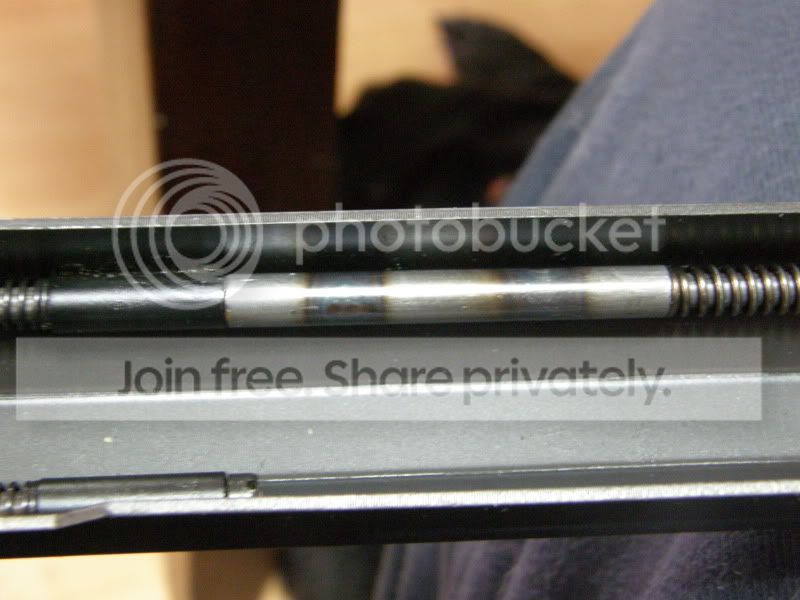

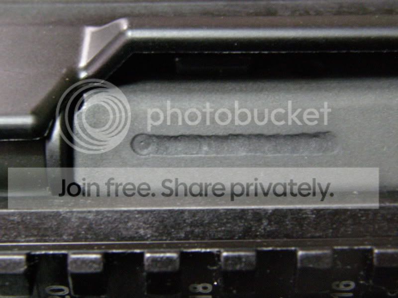

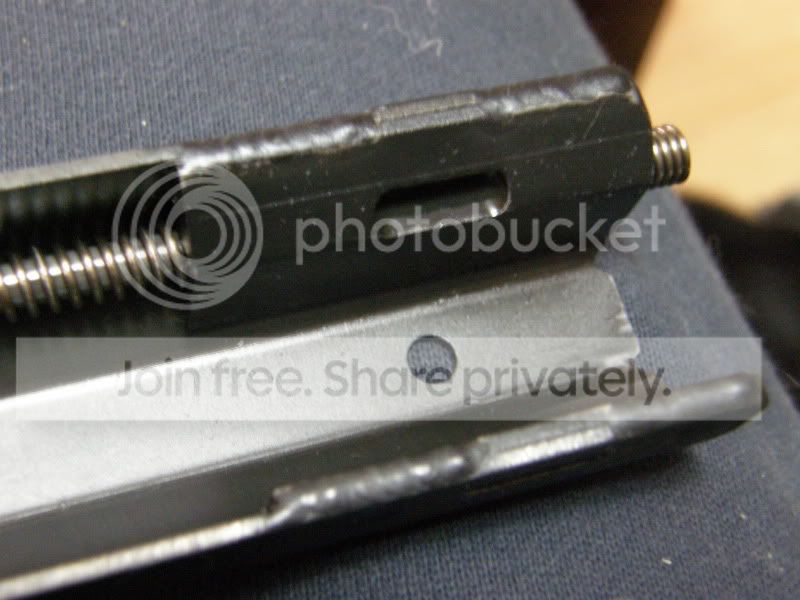

The overall construction is top notch. There are some welded parts that were tig welded, a bit more care in filling and sanding would have made these invisible after parkerizing, but they all appear very sound. There is a slight variance in the seams of the plastic parts which I will address this weekend before heading to the range with either a very small file or a sharp knife.

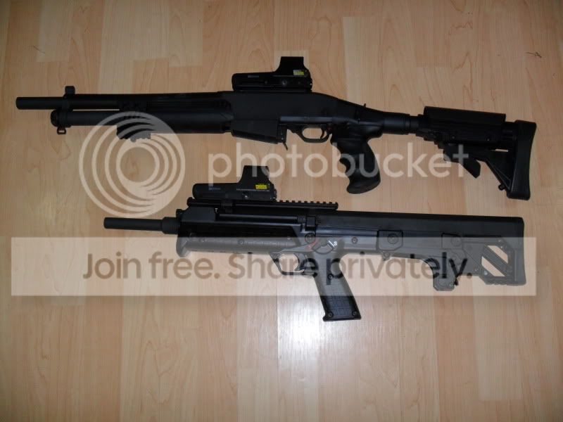

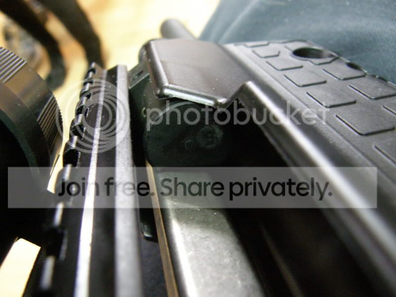

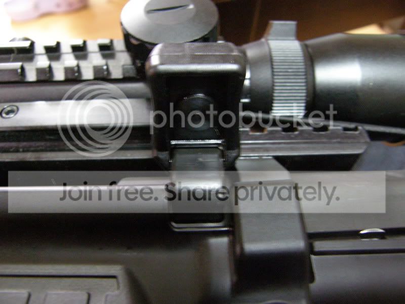

I already have a Burris PEPR QD mount coming as well as a cheek rest for it. I am trying to decide between a Vortex Viper 1-4x24 or Sightron 1-7x24 for the optic for it. But until I get a decent optic on it I will not post any range reports. I have a crappy Bushnell 3x9 on it for the upcoming range day just to have an idea where my rounds are going to set the gas setting and test it out. I also have an EOtech (copy) I am planning to try out and see how bad it really is. One thing I noticed after mount the EOtech (copy) was that objective height seems low for me and the base of the optic gets in the way of the cocking lever due to the wide base. I don’t really trust either of these optics that much and hence why I want to wait until I have something better to post a range report but think that the recoil of the .308 will test them.

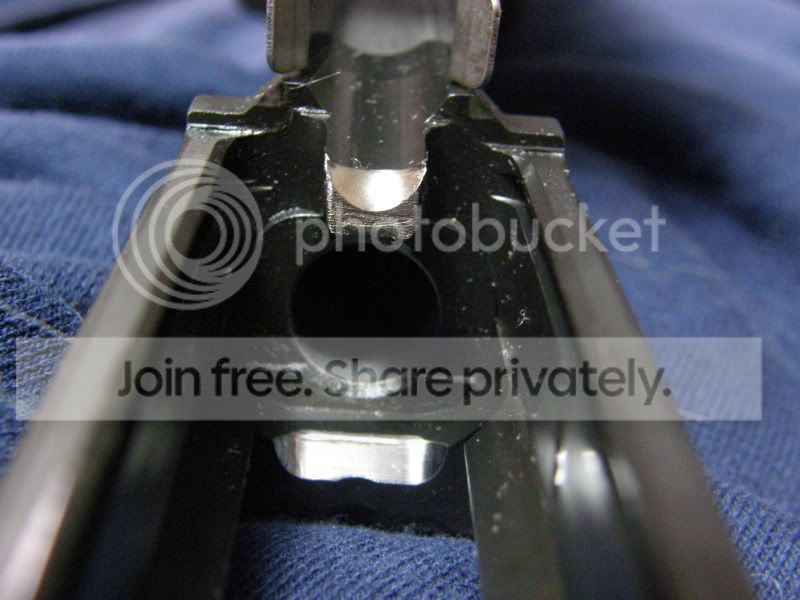

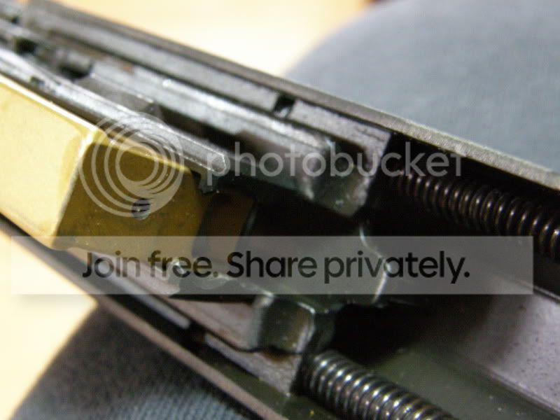

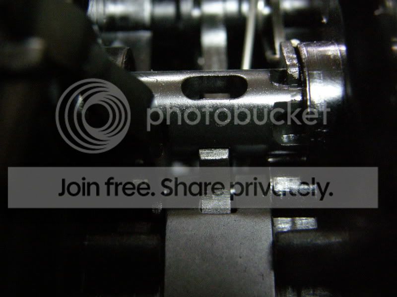

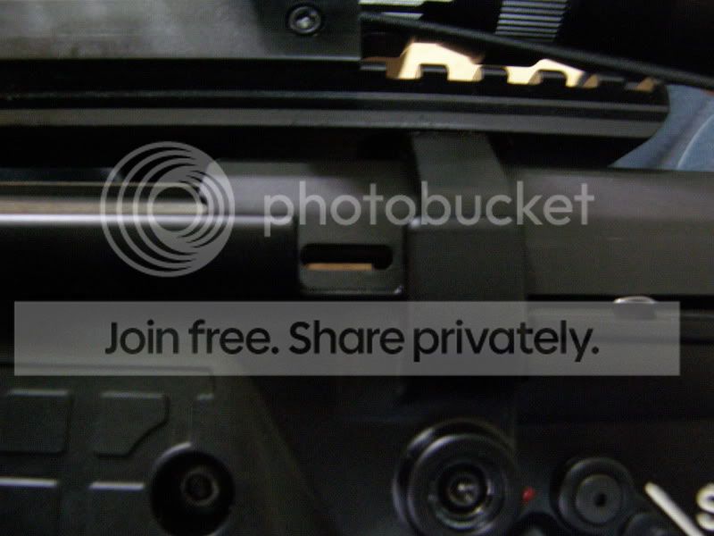

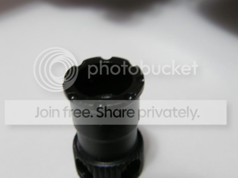

Just took a bunch of photos of areas I had not seen online. 24 New photos being up loaded at this moment.

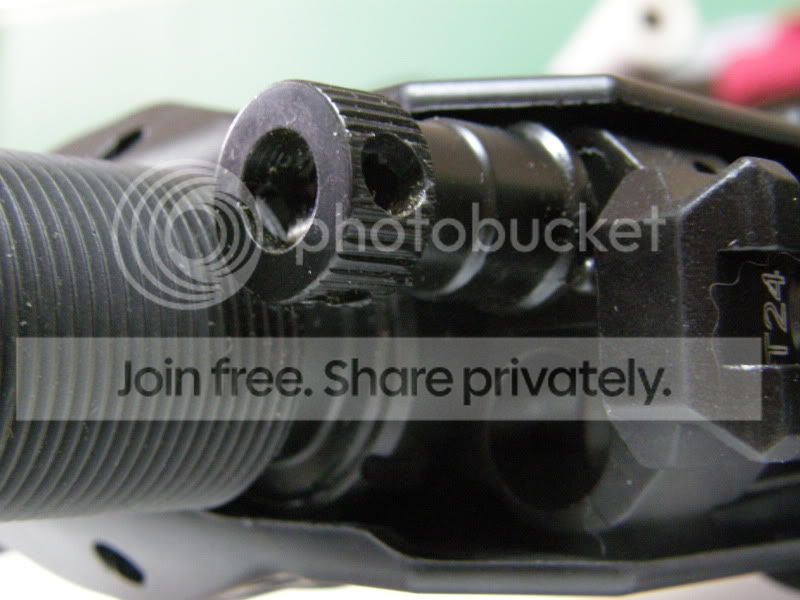

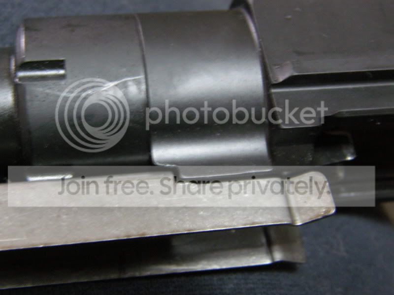

Gas Key at +10 waiting to be tested.

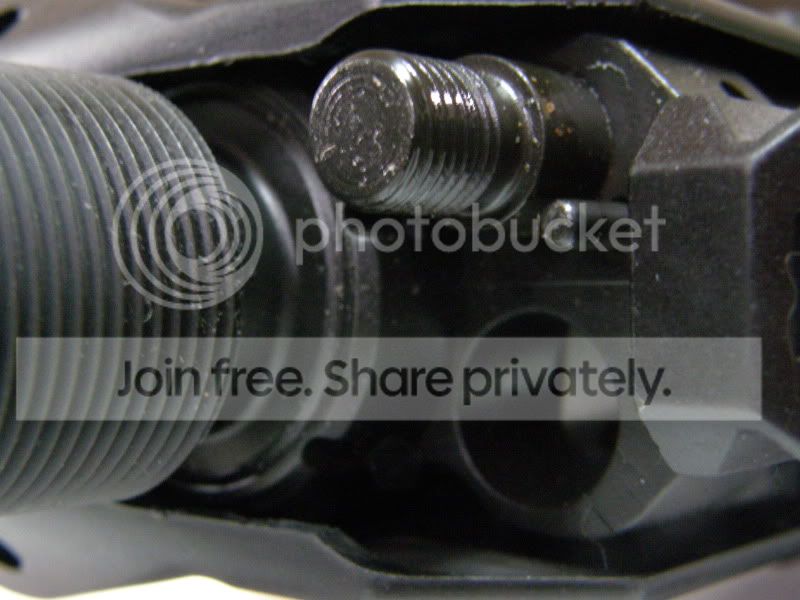

Gas key removed to show detents.
The pin that actually moves when operating the gas plug, visable after removing the gas plug.

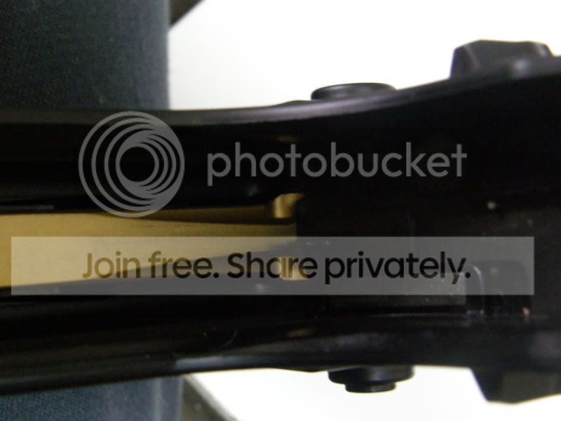

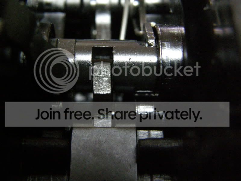

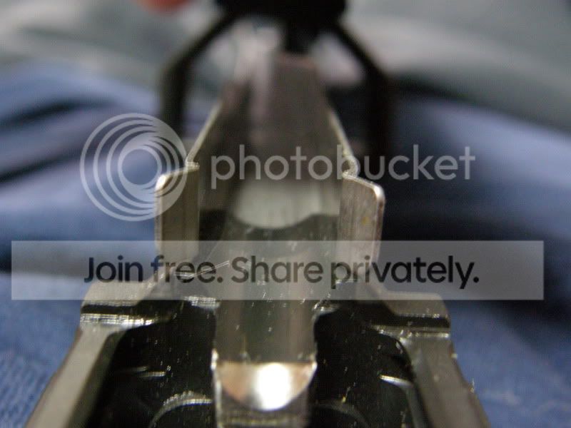

View inside the Mag well with the bolt closed.

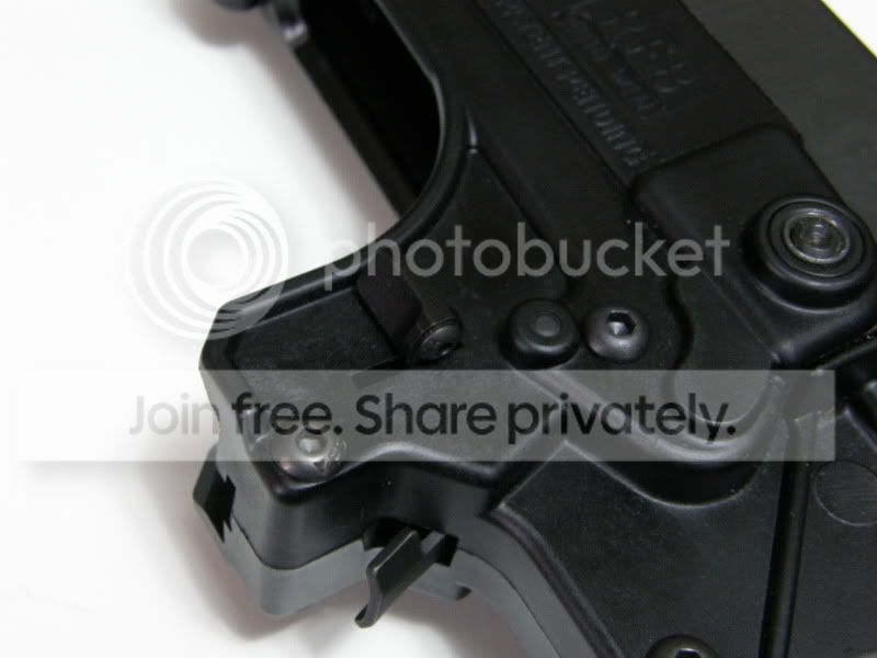

Bolt catch engaged behind the mag well, above the mag release.
Some of the welded areas as mentioned earlier.
Chamber

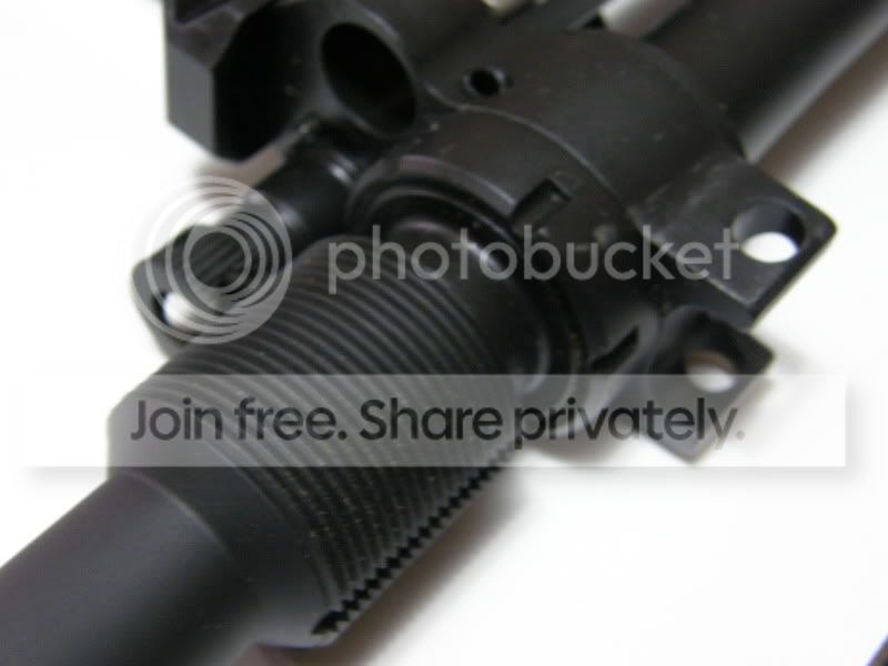

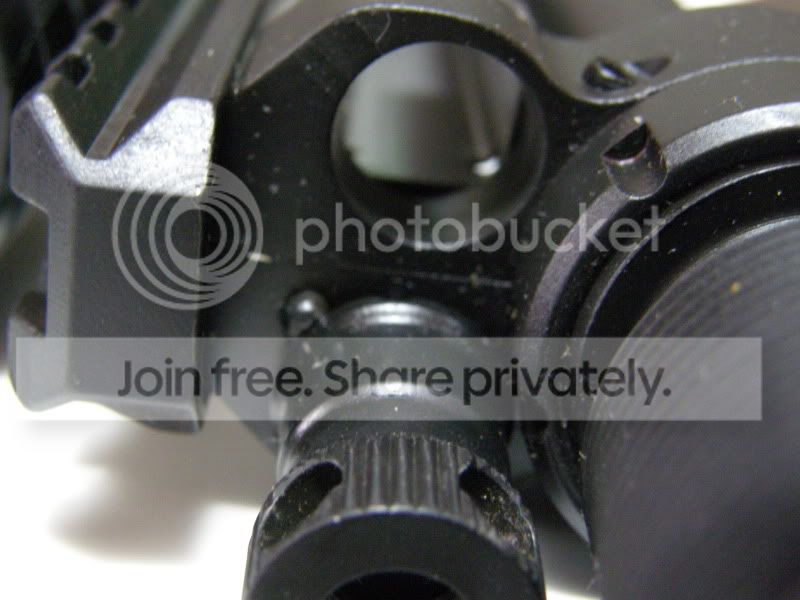

Some of the barrel/frame details

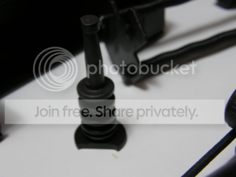

Piston/Gas Plug installed
