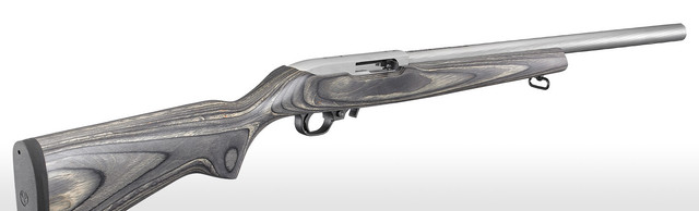

My first 22LR purchase is the Ruger 10/22 Target 20" Stainless Heavy Barrel.
I got it new as a trade in for my first hunting rifle, a Weatherby Vanguard 2 with a terrible scope. Turns out I have no time to hunt and prefer recreational shooting, so it had to go. I have to mention, I wasn't certain it was a good trade, because I'm not a fan of the semi-auto rifles. I like the precision side of shooting, but I'm impressed with its performance.
It's a heavy bastard for sure. There won't be many freehand shots taken. From the bench, off of my cheap Amazon bipod and no rear bag, it shoots surprisingly well (with the right ammo).

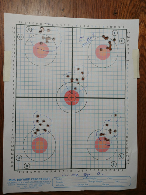

Here are some todays targets.
Not great, actually pretty terrible but to be expected. 50m with CCI Sub-sonic. 10 rounds each.

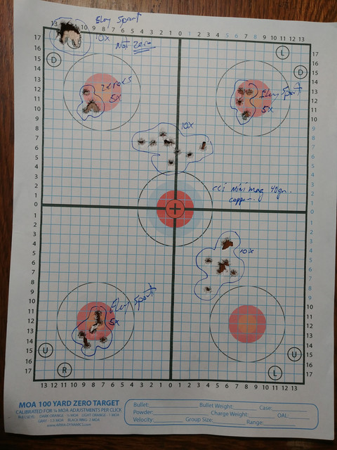

Bottom three groups are a LITTLE better, but not much. 50m with CCI Mini Mag High Velocity CPRN.
The top three groups are ELEY Sport. The first group of that (top left) wasn't zeroed for it, the following two were. Much better results.

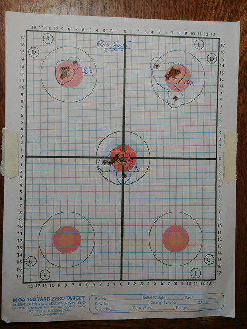

and finally the all ELEY Sport groups. I definitely pulled a couple. I've only been shooting since mid 2017 and I'm looking forward to pushing this rifle to it's max capability (as well as mine).

What do you want to accomplish from this rifle? Group sizes are starting to settle down. For 50m on a new rifle, that’s not horrible, especially with stock barrel and trigger.
