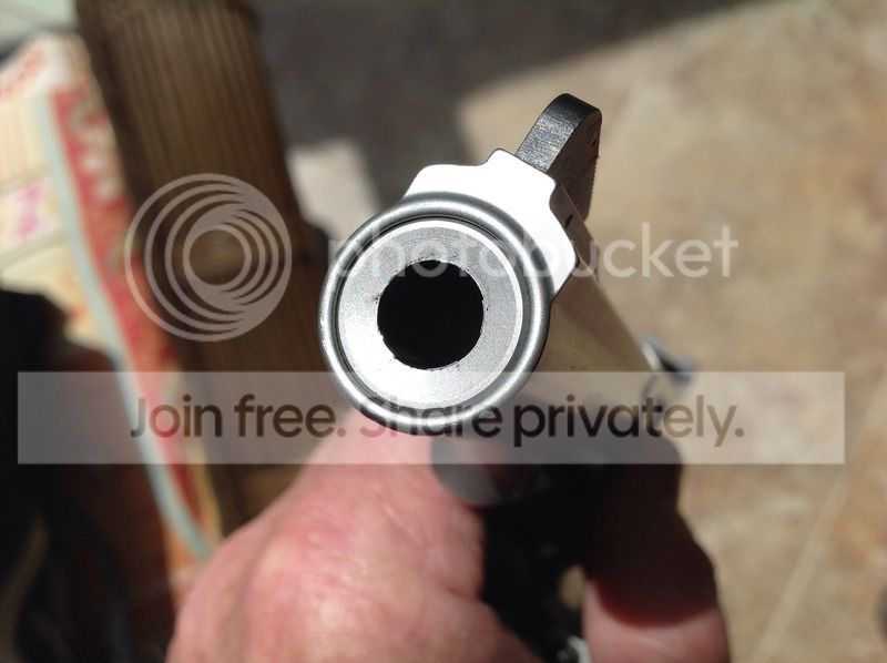

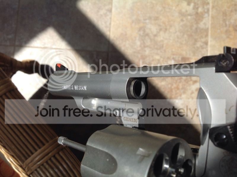

Just bought a brand new Smith and Wesson Model 66. Havent fired it yet. Just wondering if Smith using barrel sleeves now.
Heres a couple pics, not sure what im looking at, if this is just the way they machine them, or if they insert barel sleeves now.
Have a look,
Yes. Sleeved and heat fitted to the barrel shroud. Barrel sleeving is not new or exceptional either. Somewhat more economical or a new process for S&W. The downside is the continued use of the 1 in 16" barrel twist.

Pretty sure the sleeve is held on by screwing in the barrel.
