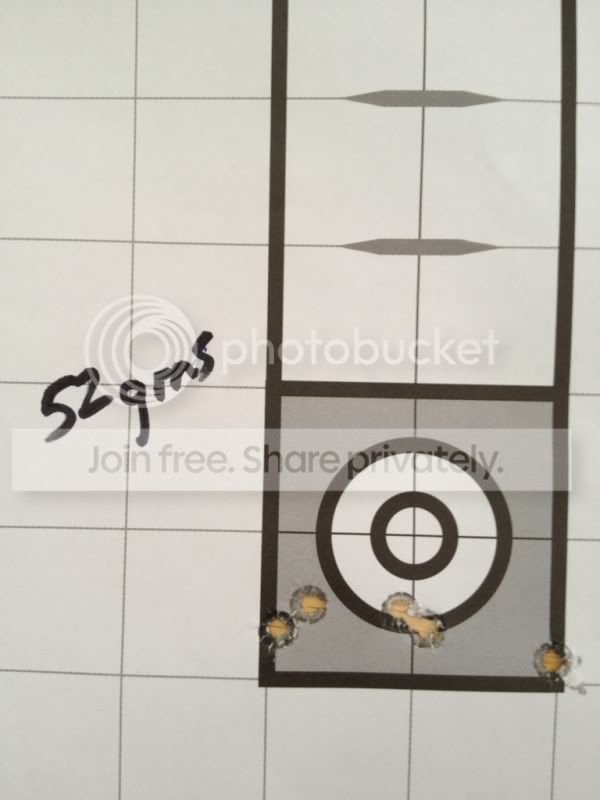

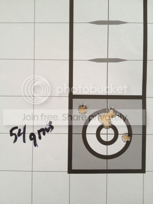

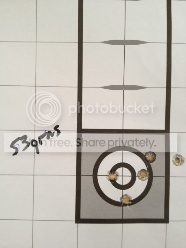

I was back at the range on Wednesday working up loads again. this time it was hornady 150 gr sp with H4831. I loaded 40 rounds 10 of each 52, 53, 54 & 55 grains of h4831. I shot 5 shot groups starting with the lightest load. there were no pressure signs at all. for the second set I shot my groups starting with the hotter loads working back down to the lighter ones.
55 grains provided the tightest groups of the day on both sets of 4 groups.

Outstanding! Trigger time can provide some more. But you have a shooter there. Stick to the fundamentals and just shoot it. All the details (bedding, reloading practice, match prep) may help with wierd shots or provide 0.1 or 0.2moa. Just enjoy that rifle and knock down some game. BTW, sometimes the mental edge will bring back those darn un-cooperative shots. Can't count how many times I get a good string going and blow off a shot. Well done!

That 52 grns target is sure interesting.
You wouldn't per chance be canting the rifle slightly?
Those breaking paper holes sure are sweet.
Mickey Mouse ears....... :)
it's possible. that was the first group I shot after 3 fouling rounds. I shot those groups in order, then worked back down from 55 grains stopping at 53. I didn't shoot the last 5 rounds of 52 grain loads as all the other groups
were fairly consistent in size for each given load. I broke the remaining 52 grain loads down today to be reloaded. it was pretty damn cold and windy that morning, so I'm sure operator error may have played a part.

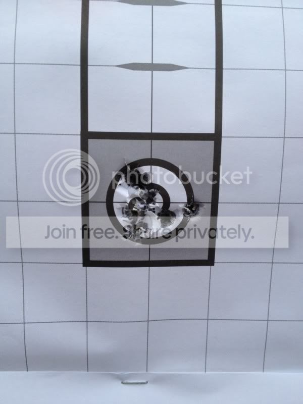

I was at the range again on Sunday with the .270 working on loads for 140gr Hornady SSTs. I had a few good groups but this was the best, 10 rounds @100m in 18 minutes. I'm very surprised the group did not open up a lot more from barrel heat. I usually try to space my shots more than 5min apart when testing loads but it was cold and miserable Sunday and I was tired. I haven't measured the group but the grid is 1". the guy on the right was the 9th shot, I knew I pulled that one and was expecting it to be much further outside the group.
edit: the load was 57.5 gr h4831, WLR, 140gr SST and neck sized win brass.
Quit while your ahead.Sure can not expect any better than that.I would have liked to see that smile, that should have been on your face!Bet its still there.
Great shooting. My brother has the package gun in 30-06 and gets the same results. I couldn't believe how well it shot with factory ammo and I cant wait to see what it will do with reloaded rounds.:eek::cool:
