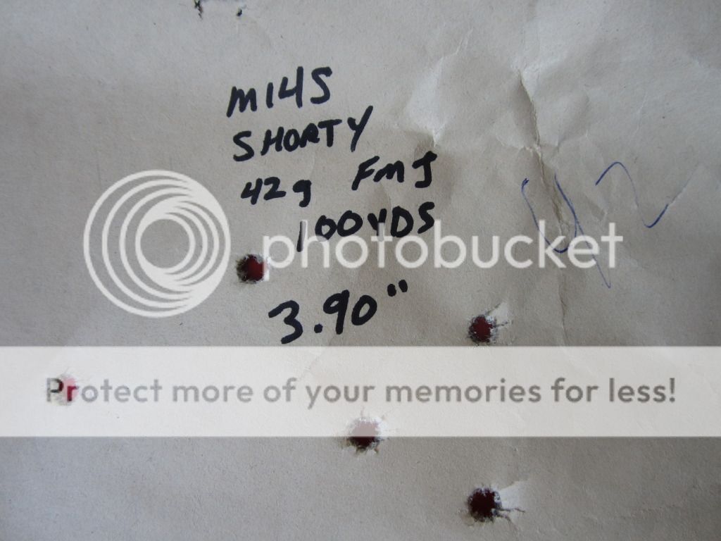

Shooting went well. I zeroed at 100 yards using some milsurp ammo. It grouped 3.9" off bags. About the same as my SKS and not quite as good as my CZ858.

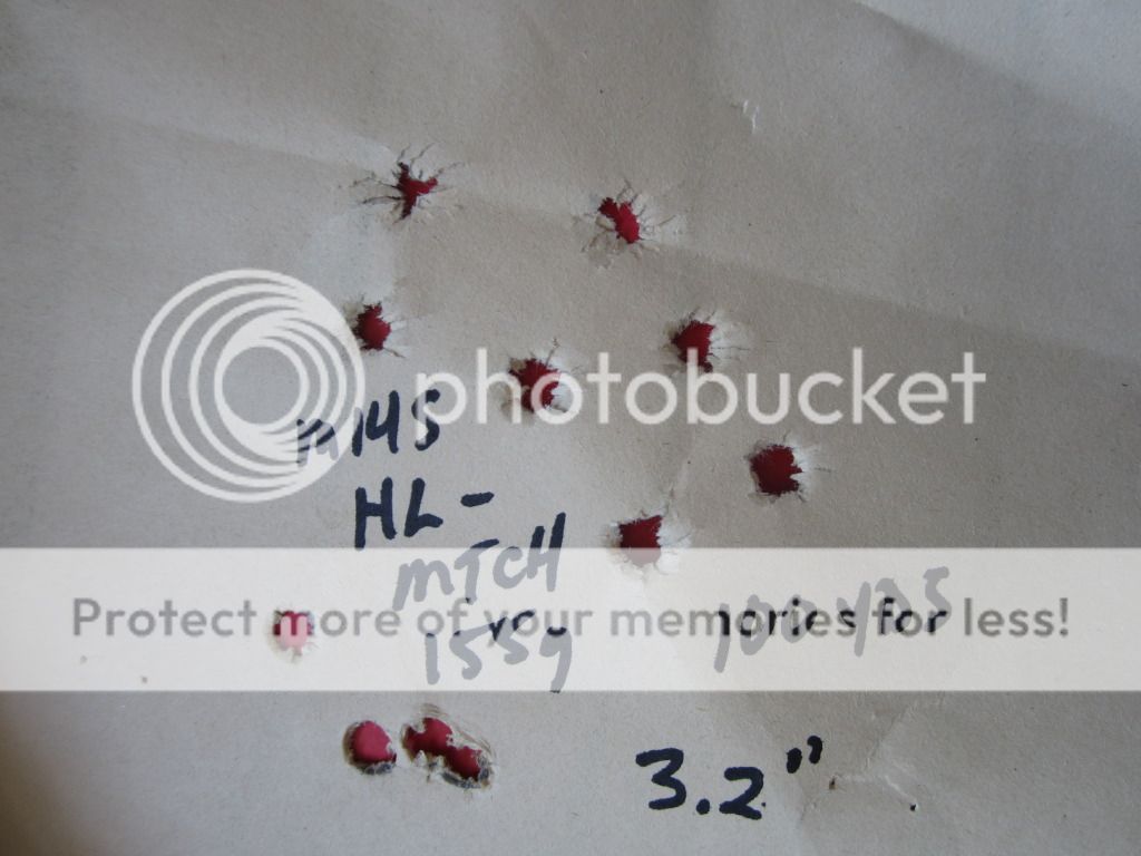

10 rounds of an unknown left over match ammo (155gr bullet) grouped 3.2". Good enough to be useful.
