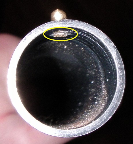

I just got a new inexpensive shotgun for rainy days.
It is from "Armed Guns", yet another Turkish company.
For the price, it looks and feels right. But I just noticed this:
The sight is sinking about 1mm deep in the barrel.
Since I got it by mail order, shipping it back will be a pita.
Should I bring it to a gunsmith to grind that thing off... Or just shoot it like that?
What do you think?

Meanwhile I just hanged up the phone with a gunsmith. He told me shooting it will not even it out.
He also told me the same thing as Winchested wrote. The wad will rip, plastic will accumulate there and I will get a sh-beep-y pattern.
I'll probably dremmel it myself although the smith told me it's a 5min job and will cost peanuts.

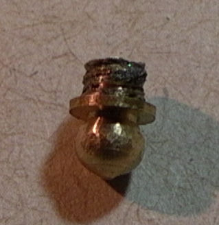

The sight was not glued ... Easily unscrewed.
Mugshot of the offender
I'm definitely going to take care of it myself, put some threadlock and forget about it.
Thanks again guys. It was indeed a DYI.

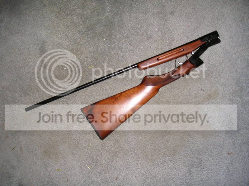

What kind of gun is it in the first place. Would like to see the whole gun in a picture.
Brand : ARMED GUNS
Model : SBS 12, 28 SINGLE BARREL SHOTGUN

I had bought a shotgun some time ago and the barrel was cracked from the sight hole to the end of the muzzle. I was told it was because someone likely installed a new sight bead and it was protruding into the barrel instead of being filed flush.
