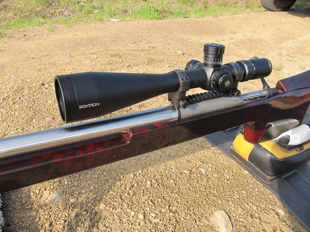

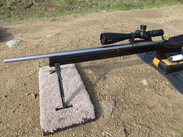

I think you are going to need to get BEEFIER rings... Wowsa!!!!
nice kit.
Yes, yours is the first on a rifle that I am aware of... Maybe a new bipod is needed too? :)
How's the view?
Jerry
PS.. just cause I am fussy, consider moving the rings further apart. Supports the tube better and there is now zero chance that ring compression can muck up the mechanicals.
View is great! Yeah, the Harris hasn't got a life on this one. Still look'n on an LRA. Thanks Jerry!! Richard from Near mfg. is a great guy. We tried 4 mounts before settling on the milspec mount to get the sunshade to clear the front rail. The eye relief is wonderful! I really can't wait two more weeks to try it out. I'm gonna die!
Edit: Jerry, you can't move those rings. They're attached to the mount. Also, that tube is not 34mm. It was very tight in the rings and they are milspec 34mm. Richard mic'd them and the rear tube is 34.0021 and the front is 34.0016. Yet the measuring slug fits perfectly in the rings. Go figure! But from what Richard told me, NF tubes are the same. The only ones that really are perfect every time are the S&B scopes.
I did ask him about the distance from the turret. He told me there shouldn't be any issues. I did range the elevation and windage knobs all the way through their range with no issues.
I am very happy you are enjoying the optics. Yes, the eye relief is HUGE... way better then S&B
Anytime, you have tolerances to the 3rd decimal place, I will call it good. That is well under 1 thou so....works for me.
0.0021mm is 0.00008"... That is tough to measure a tube to that level of accuracy but certainly well within any manf tolerance in sport optics.
I mean to move the rings further along that rail. You have a bunch of empty slots both fore and aft that will still keep the ring over the receiver. Again, not a biggie but something I do just because.

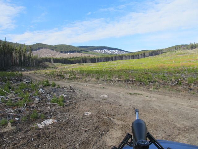

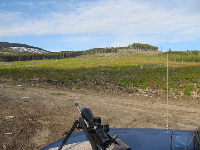

Had a wonderful time this morning out to 1500yds with the SVSS on my 6XC. Air was almost calm so really nice to confirm tracking at LR.
The scope tracked reliably and consistently at the 2 targets at 840 and 930yds I as plinking at. Once I had the dope for the target, I just started mucking about reaching out further and eventually dialed out to 1500yds.
6mm/105gr hrn is pretty darn small and the ground was soft/wet so saw only a few hits. Dialed back to 930 target and smoked it on the first shot.
Then to 840 and hit.
Let it all cool... "cold" bore at 840 hit. Then dial around then back to 930, hit... then back to 840 hit. Good enough.
Optics and focus continue to impress and now I am satisfied the tracking on this scope is also as good as the glass.
Jerry
