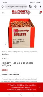

7-8 week wait list in Calgary, 3 weeks ago when I got on the list. Flashing went up $12 on Amazon, after I bought the "last one".
Imagine that! See below ref material.
At those prices, buy a check making die
Got any recommendations as to dies and materials? My brother works at a sheet metal place, so I know I can get the material. Just what thickness, do you recommend ?
Even cheaper, I made my own. Drawings are available on the net.
This is what I use. "Standard .014"
I had to go to the contractors desk and get them to order it in. The usually only carry the economy grade.
