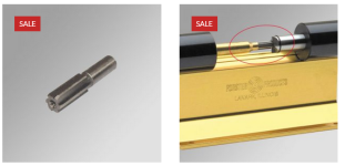

Hypothetically - if I want to manage the brass neck wall thickness
and the OD is already formed to chamber (on shot shells)...
I saw some reamers for ID but have not seen any in 308 size.
How that "Reamer" shall be mounted? In a FL resizing die, or in a little "neck" turning lathe?

I am talking about this reamer - but I don't see it in 308.
In my eyes a better concentric/runout precision if this would be part - or an addon of a FL sizing die?

What I see that pilot for neck ID could be a "reamer" as well. Any MFG makes that product?
