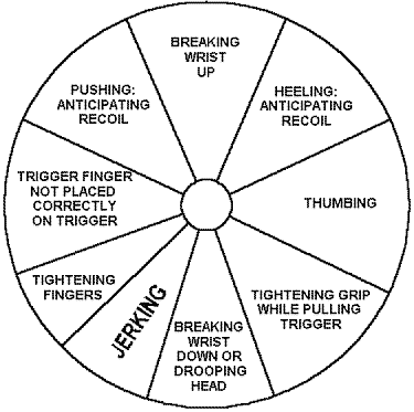

It's most definitely you. Even out of round projectiles or inconsistent components or loads would not result in consistent trajectories to one direction only.
Try printing this out an putting it up as a target so you can instantly see what you're doing wrong.
