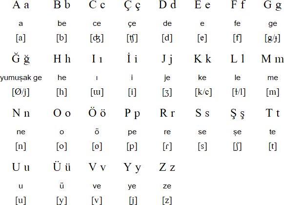

No idea what language it is - maybe turkish? But if anyone can translate, that should tell us where these M1's were sourced.
Here is the modern turkish alphabet, and the markings can definitely be turkish - though I have no idea what it translates to.
I've looked all over and I'm pretty sure the markings are modern Turkish. I'd say these are from Turkey, though probably not through the CMP. CMP only gets guns back that were sent out as foreign aid. If the receiving country bought the guns (i.e. they weren't free to begin with), then they are usually sold on the open market (or destroyed, but countries like Turkey would sell them, not axe them). Turkey would have had Garands through both procurement methods, so I'm not surprised they are selling some instead of returning them through the CMP program.

Yük is Azerbaijan for “load” not sure in the other words. Turkish probably shares some language links.
edit:Turns out yan means side there too. So along with expatriates info looks like you’re bang on.
