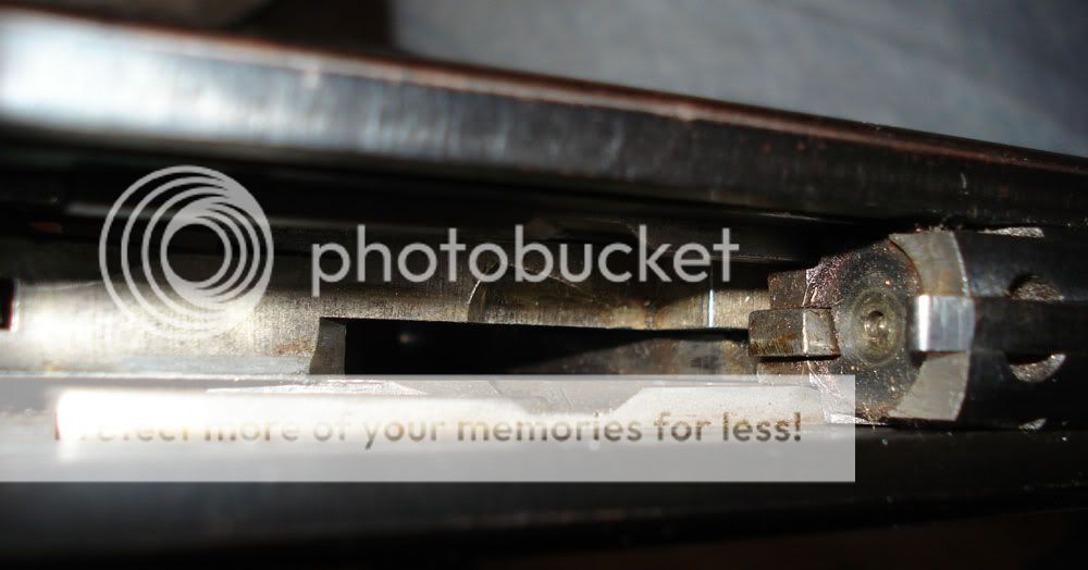

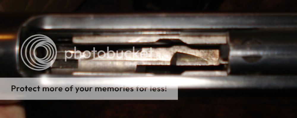

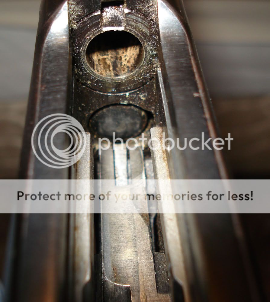

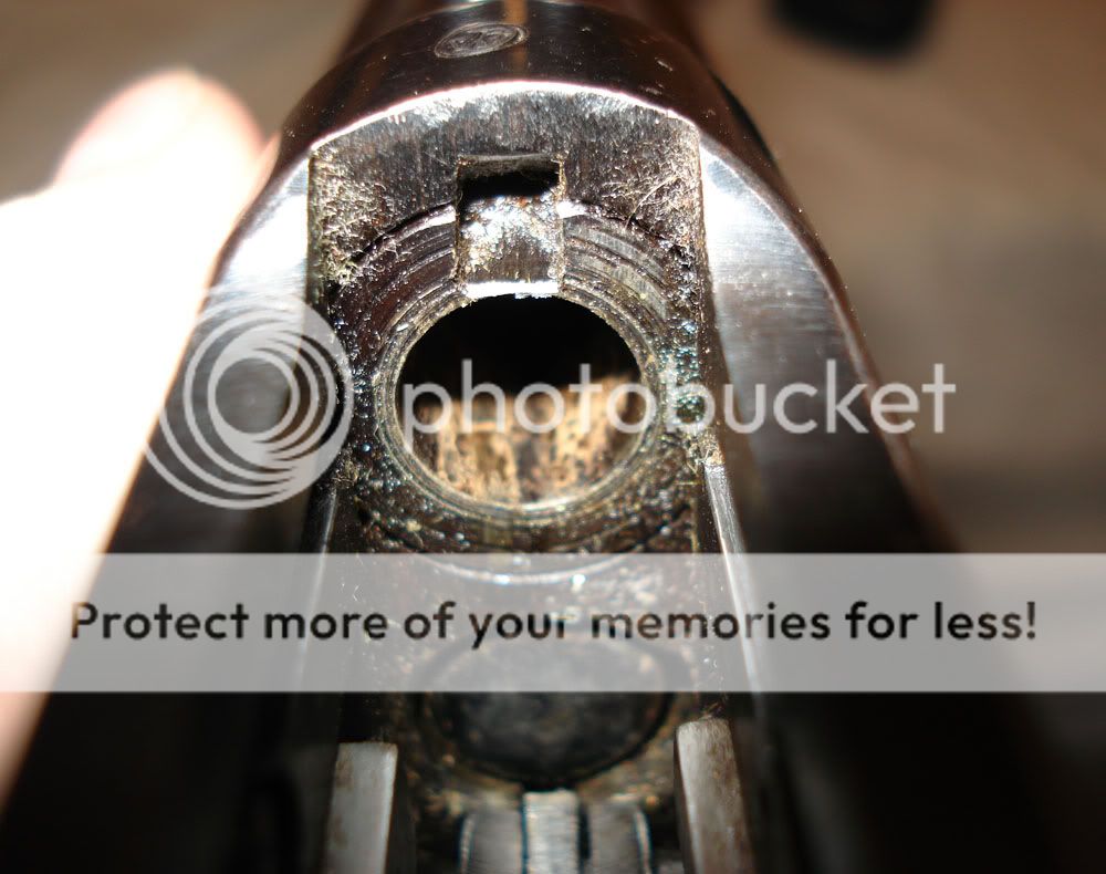

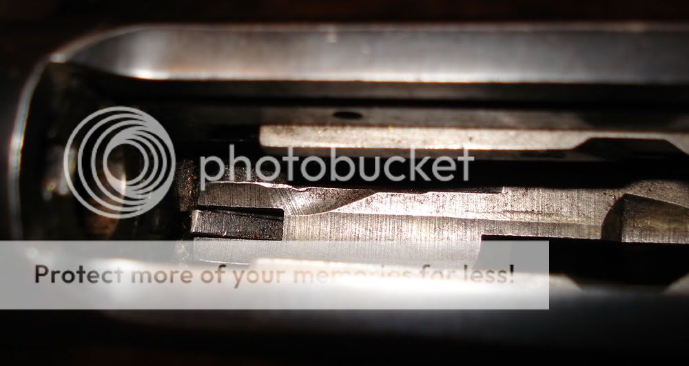

I took these pics. See if you can see anything amis.
I'm sorry about the cleanliness. apparently it looks ALOT dirtier with a macro lense and a flash. I Haven't done anything to it since I got it so that's from the last guy not taking care of it.
It doesn't sound like it's doing anything out of the ordinary, but you should probably clean some of the gunk out of the chamber and receiver before you shoot it; it looks like there might be some rust starting in the chamber, and that WILL give you extraction problems. If nothing else, a good spray with brake cleaner and some compressed air would probably clean up the way it feels.
The chamber looks terrible, I hope it's the photo.
Time for a good cleaning. It could easily be your entire problem
By any chance has the extractor been replaced recently? A friend of mine got an aftermarket one, and it was a tad too long.
Might be a good idea to oil and free up the extractor while you are cleaning that chamber. It could be siezed in the groove, although that's fairly rare.
What I can see of the '***' Geeze you can't say ***, OK TEAT! I described in my first post, (it's the piece sticking up through the cartridge guide in your second to last pic) looks slightly worn, so don't absolutely discard that idea. If it were the problem though I would expect strong bite marks on the case rims.

Wow! Needs some TLC for sure. That rifle is going to be very happy in a new home where it gets lots of attention again. :)
I'd use "wipeout" to get everything out of the chamber and bore, because unless the pic is misleading it would be well served by a thorough cleaning. It could simply be that pushing the cartridge into the chamber has enough resitance to cause the symptoms you notice.
While the bolt is out use brake cleaner or something similar and get the gunk out of all the nooks and crannies. Make sure everything moves freely within the bolt.
