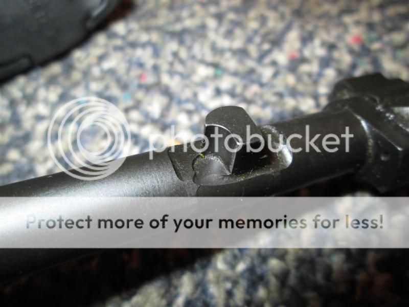

So here's the pic's Stevo. This is after 200 rounds or so.
And for anyone else who just got there XCR-L, does your's look like this after 200 rounds?

well i just got back from the range. put about 160 rounds through her. My bolt catch has a significant amount of wear on it now. ill take a photo tomorrow and through it up here. But i dont think its the actual bolt catch giving me problems. So after the last round of a mag ill reload, throw the mag back in and the bolt catch will be sold (this was happening about 30percent of the time). I have to get two thumbs on it to release it. The strange part is once the bolt catch is free the bolt is still stuck in the rear position. I can watch the bolt catch inside the receiver move freely up and down but theres no actual contact on the bolt to the bolt catch. So id give the receiver a swift smack with my palm or slid the charging handle back firmly and then the bolt would fly back to it forward position........ In my mind the bolt assembly is being lodged somewhere in the back part of the receiver or stuck in that bolt buffer in the rear. So thats where im at...........

Can we get a couple pics of your bolt carrier?
J
bremmy, here's a couple of pics of the same areas on my rifle, which has about 3k through it. Your wear does seem excessive when compared to mine. There are no burrs and hardly even any marks on the bolt catch. I use grease on it, including on the bolt lug. How have you lubed yours?

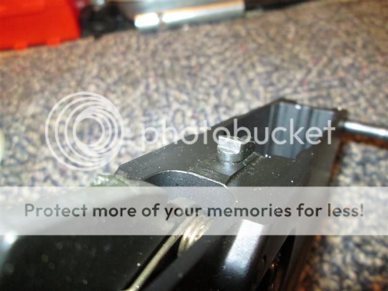

Well back from the range again. 150 rounds through her and this is what i got. bolt still has the occasional stuck in rear position thing happening and i think i know why now. also curious to know if everyone else is using brass coated surplus ammo, laquer coated or actual brass casings?????? and as for lube im using G96 which works amazing as a cleaner and lube for all my other guns.

The grooves in the oprod are 15-20 thou deep.
[URL=http://s1365.photobucket.com/user/bremmy777/media/boltcatch_zpsb297f37b.jpg.html][IMG]http://i1365.photobucket.com/albums/r749/bremmy777/boltcatch_zpsb297f37b.jpg[/URL][/IMG]
the wear on my bolt catch continues and now has more wear on the top edge, top surface and the burrs continue to deepen.
so i think the problem lies in these grove being worn into my oprod. I think they're literally diging themselves into my bolt carrier and seizing the bolt in the rear position....... when stuck back it only takes a swift smack on the receiver the get the bolt back into the forward position.
If the piston is stuck in the bolt carrier because of the burrs, I can't see any way that would cause the whole assembly to hang up to the rear.
