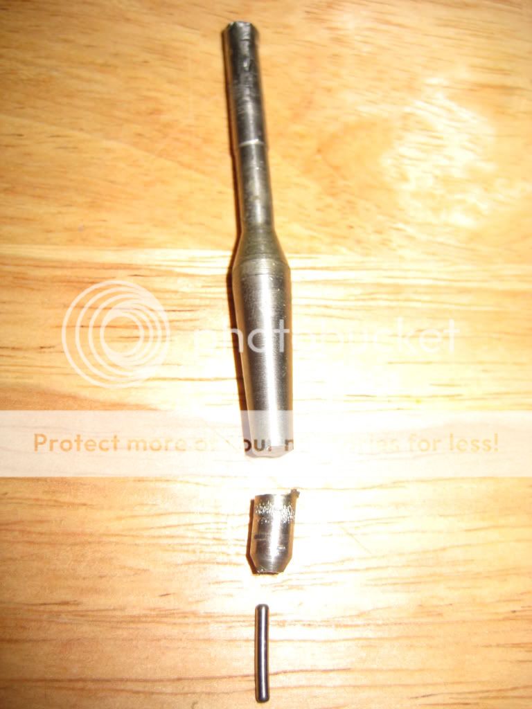

-broke the decapping pin tip off.
-hacksawed off a bit more of the pin.

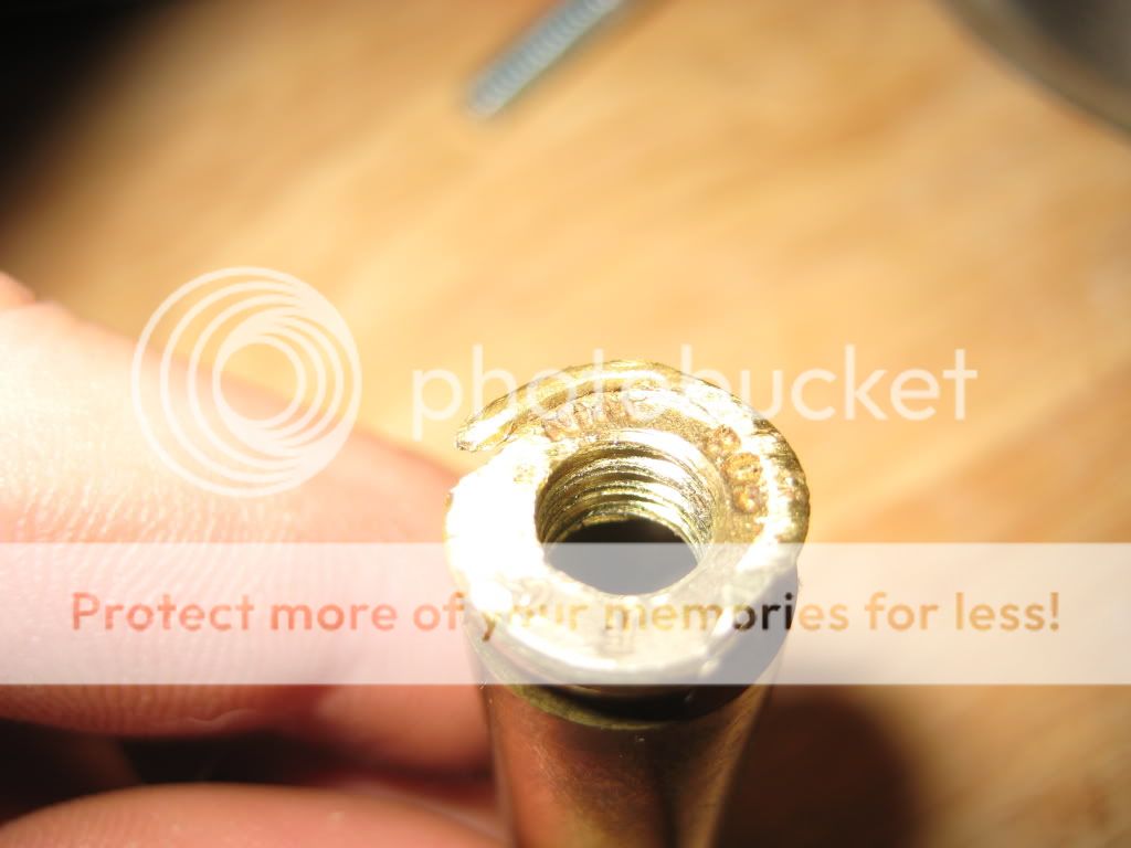

-drilled the case with 7/32 drill bit.
-tapped it using a 1/4 20 tap

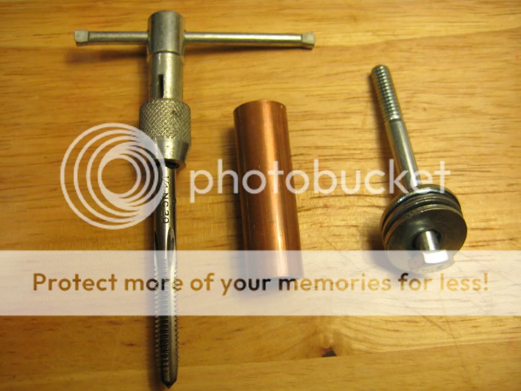

-unscrewed it out using a bit of copper pipe and a bolt that was holding my press down.

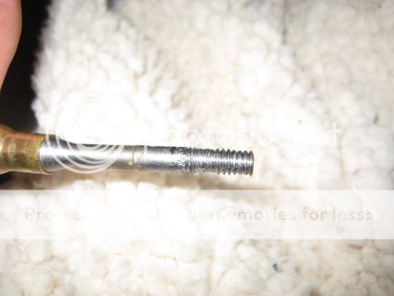

drilled and tapped...

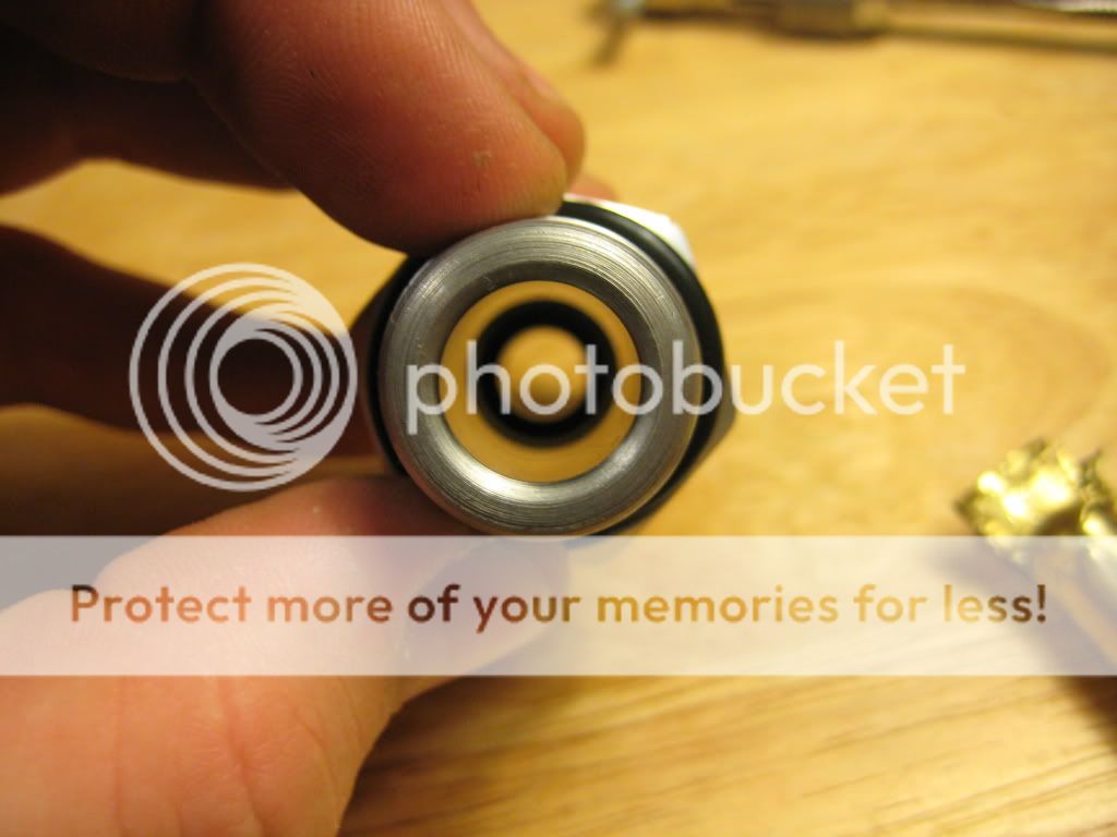

the die seems to be ok...

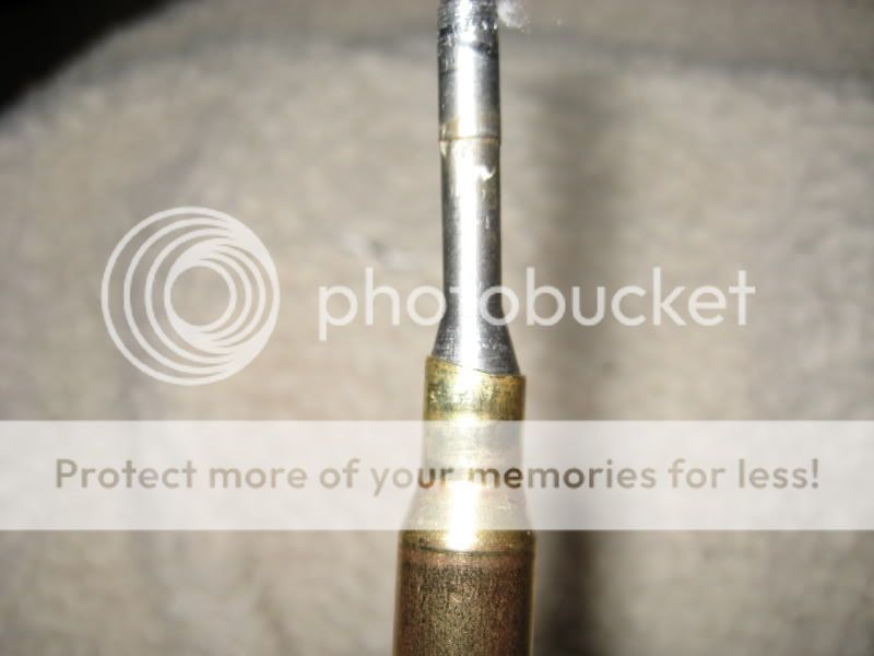

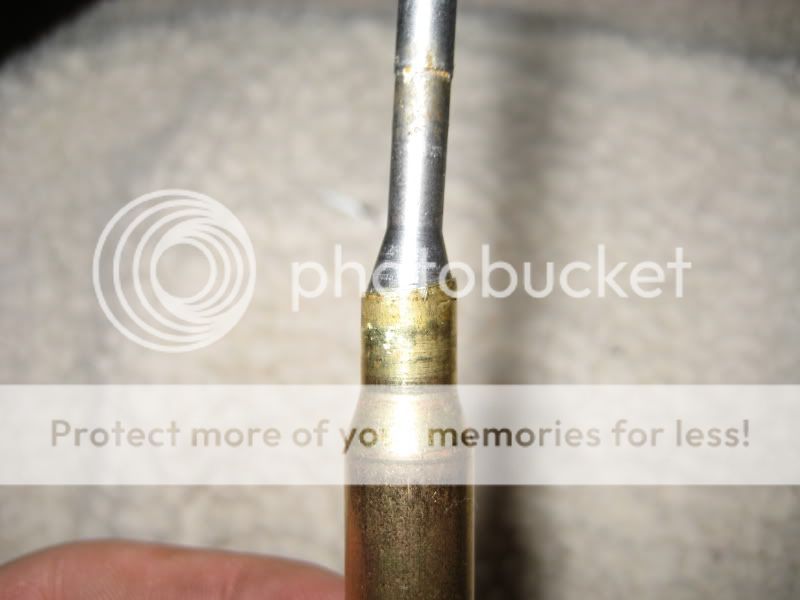

poor decapping pin...for some reason I wasn't able to pull it back through the top of the die. I had to snip the case mouth to even get it out of the case once the case came out of the die. If I could have pulled it out the top, everything would have been salvaged. any hints on this one?
homeade extractor...This actually worked awesome...I really didn't think it was going to budge, but it pulled it right out. I wish I would have taken a video now...

The die looks fine, but I'll need to get another decapping pin - which I'm guessing will be just as cheap to buy a new RGB Lee die set(17 bucks).
