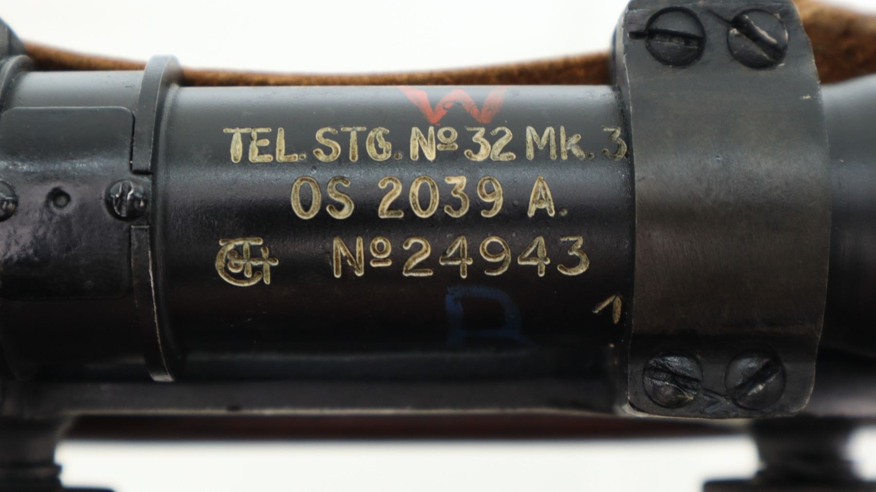

The focus on those scopes is adjustable:
Graticule Focus Repair
One of the Mk3s that came to me had a drop at sometime in its history and this may have taken the image and graticule out of focus (a significant dent is evident at the objective lens housing). This can all be remedied with a thorough overhaul, however this is not planned or possible for a little while. The No32 design did provide a method of re-focusing that was leveraged by workshop armorers if all else was well (as in this case). Under the characteristic square plate in the mid body (held with 4 x BA cheese head screws), is a erector locking segment, when accessed and removed this allows the erector cell to be gently eased forwards and backwards in its travel - if doing so while glancing through the scope the image and graticule can be focused to suit the observer. The segment is half a thread pitch assymetric so can be replaced in either direction to re-lock the erector set closest to your perfect focal position.
