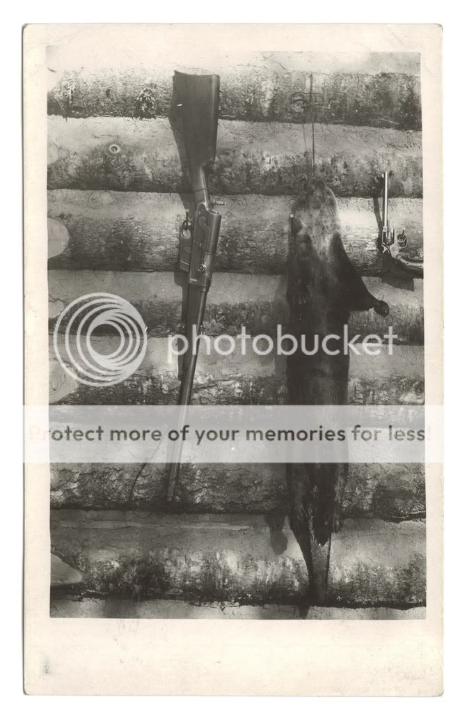

You want old school, try these:
Of course, you are welcome to use a wider sling than this. The chap that used this set up was hardcore, from stories I've heard I doubt he knew what pain was. lol
There are at least some period pics for you to see what the trappers did in the day.
Get some heavy leather boot lace, treat it with some bear or sheep fat and tie it on for the sling loops. After that use the sling of your choice. The butt could have a leather slip over sleeve I guess too.
Hope this helps.
