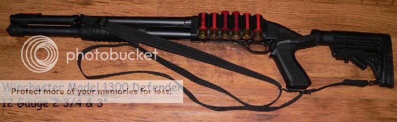

Hey guys,
I just installed a Knoxx recoil reducing stock on my Winchester 1300. The stock sits a little higher than it does on my 870 clone and, because I am one of those no neck hobbit types :) I cannot get my head into position to draw a bead down the barrel.
What I'm looking for is a front and rear sight setup that I can have installed on my 1300 to alleviate this problem. The gun is mainly used for bear protection so actually being able to sight and shoot would be great!!!
Any suggestions are appreciated.
Thanks.

How was your site plane with the factory stock?
As far as I can tell you have two options. First, why did you install that stock on your gun? If it's a full length hunting gun, I just cant see that. I'm assuming it falls under the "other" catagory. By far the easiest option would be to install a mount and scope or other optic. I'll never recommend a battery powered sight for anything, but lots of guys like them. I believe the stock you installed was really meant to be used with some form of optic. Your other option would be to have a shim made up out of some material that will ad a bit of drop to your stock. It's not really a big deal, any decent shop could produce somthing to fit in the wedge on the back of the reciever, and it wouldn't take much I'm sure to get you back on target. Good luck.
Excellent, but with my arthritic bones I really need the recoil reducer. I put one on my 870 clone and just swear by it. That's why I wanted one for my Defender as well.
You're right. It does. I don't use this for birds or any other game - strictly bear medicine. I think I'll follow some of the previous advice though and install a rear sight to go with the Tru-Glo front. Thanks for your help though.
does the Winchester 1300 version of the Knoxx have a different drop at comb than the Remington 870 one? have you put the guns side by side and compared? im just curious.

I wonder if a Knoxx Compstock might not work better? Its recoil dampening isn't supposed to be as great as the Spec Ops but it looks a lot closer to "factory" parameters.
It's basically just a Hogue stock modified with a recoil dampening mechanism.
