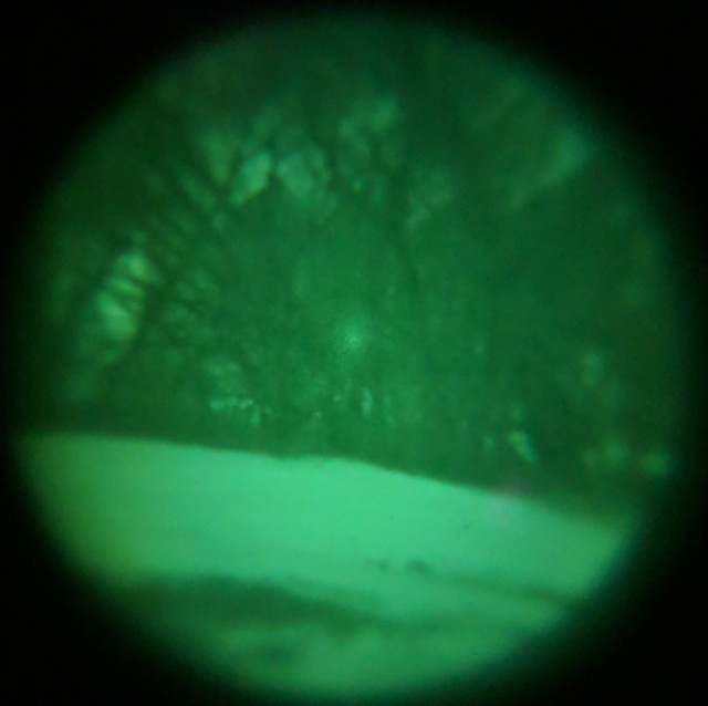

First off, we will start with the easy test:
Every night vision device looks good when used under ideal conditions. Last night was certainly as close to that as it can be with cloud cover. Looking into my shelter belt from approximately 50 yards away, it was interesting to note that even my Gen 1 Orion was reasonably capable. Note the differences in resolution between each generation and device, and the light gathering ability. I would say each device, Aurora included, shows accurately how bright the image in the eyepiece was, however all the units suffered resolution loss in my camera vs my eye, with the Aurora suffering the most.
Armasight Orion:
Armasight Sirius:
SiOnyx Aurora (note that even in the dark, there is some amount of colour shown! Resolution is SUBSTANTIALLY better to the eye):
PVS-4:
PVS-14:
FLIR Breach:
