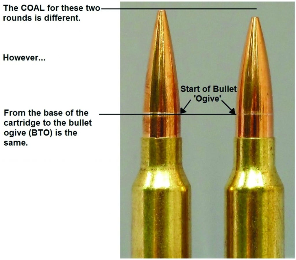

The bullets have a variation from base to tip, but are very consistent from base to ogive. It is the ogive that enters the rifling, not the tip.
Your bullet seater pushes down on the bullet close to the ogive. Your seating depth is probably very consistent, but unless you have a device like I showed you, you don't have the capability to measure the actual OAL that matters - case head to ogive.

Below a picture is worth a thousand words and what Ganderite is trying to get across. Also if the bullet tip is contacting the seater plug the OAL will vary. And the picture below shows that the seater plug mouth is what should contact the bullet ogive and not the bullet tip.

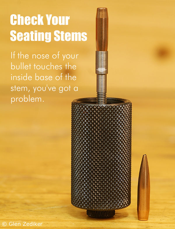

^^^this is the answer^^^
Watch Out for Bullet Nose Contact in Short Seating Stems

Invest in a Good Seating Die
Reloading Tip by Glen Zediker
The bullet seating operation is the “last thing” that happens and it’s also the one thing that can corrupt the care and treatment given to the quality of the loaded round prior. A sleeve-style seater, well-machined, goes a whopping long ways toward preserving alignment, and, therefore, concentricity. Also make sure that the stem in yours comes to rest well down onto the bullet ogive, and, above all else, is not contacting the bullet tip! That will wreck a round.
Below a Forster benchrest seating die, the die chamber holds the case and bullet in perfect alignment. The top of this die and the seater plug is pictured above.
