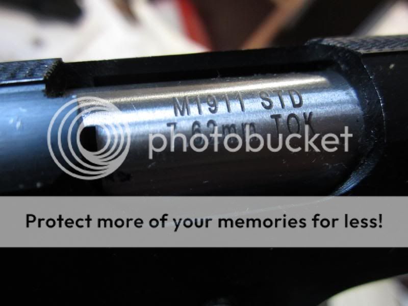

Norc 1911 in 7.62x25

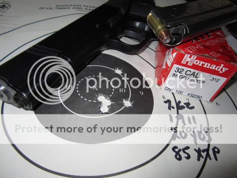

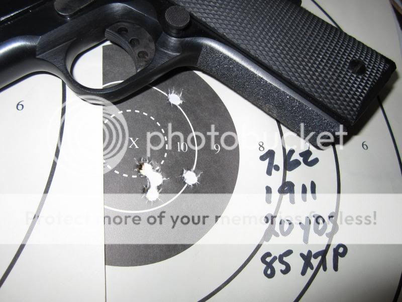

I sized the wadcutters 308. This makes them easier to seat in those little cases. I shot 5.0 and 4.5. the 4.5 was somewhat better, telling me that those wadcutters are at their velocity limit.
I now have a bullet and a load that works. I have asked R & R for a box of hard cast wadcutters, sized 308.
My Norc 1911 is now a very accurate pistol in 7.62x25, using cheap handloads. next step is to put the original recoil spring back in, or a heavier one, plus a heavier hammer spring, and try it with milsurp ammo that has the bullet pushed deeper. The need for a milsurp shooter is not high, though, because my Polish Tok shoots very very accurately with the milsurp.
