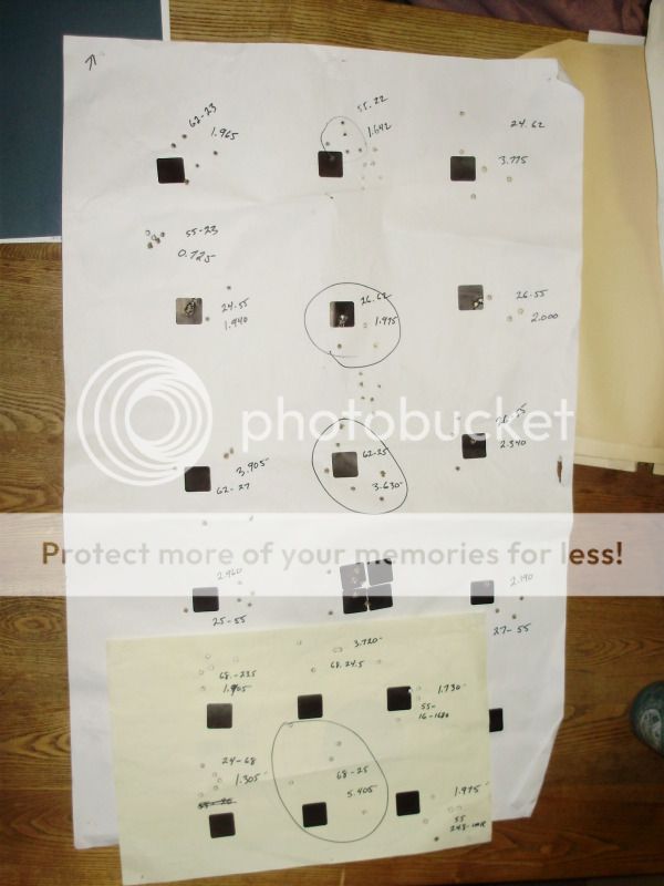

A couple weeks ago I did an accuracy test with a Norc M4 and a Dan Defense M5. This included a variety of bullets, mostly loaded with Varget, so others could relate to the powder. I got curious about my surplus powder. How accurate might it be with the two bullets I have the most of, 55FMJ, 62FMJ and 68 HPBT Match?
the Millit 1-4 scope was replaced with a 20X target scope and I shot the FMJ bullets with 22 to 27 gr, in 1 gr increments. The 68 were shot with 23.5, 24.0, 24.5 & 25.0
As usual, some loads look better than others. The most important thing is that this rifle prefers milder rather than hotter loads. This would be a bummer if I was to shoot Service Rifle where I needed enough power to shoot 500 yards. Fortunately, I don't do that any more. If i did, I would use a 20" rifle.
The target was a sheet of paper with 1" black patches for aiming marks. It is easy to aim at one corner of the patch.

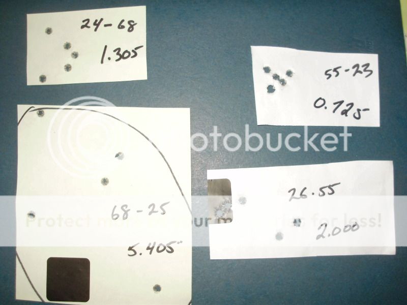

The 55s shot best, averaging under 2" (23 gr was 0.725"). The 62s were terrible ( as in past tests with this bullet) averaging about 3". And only the mildest load with the 68 was good (1.3").
These groups show what I meant when I said this rifle prefers milder loads:
