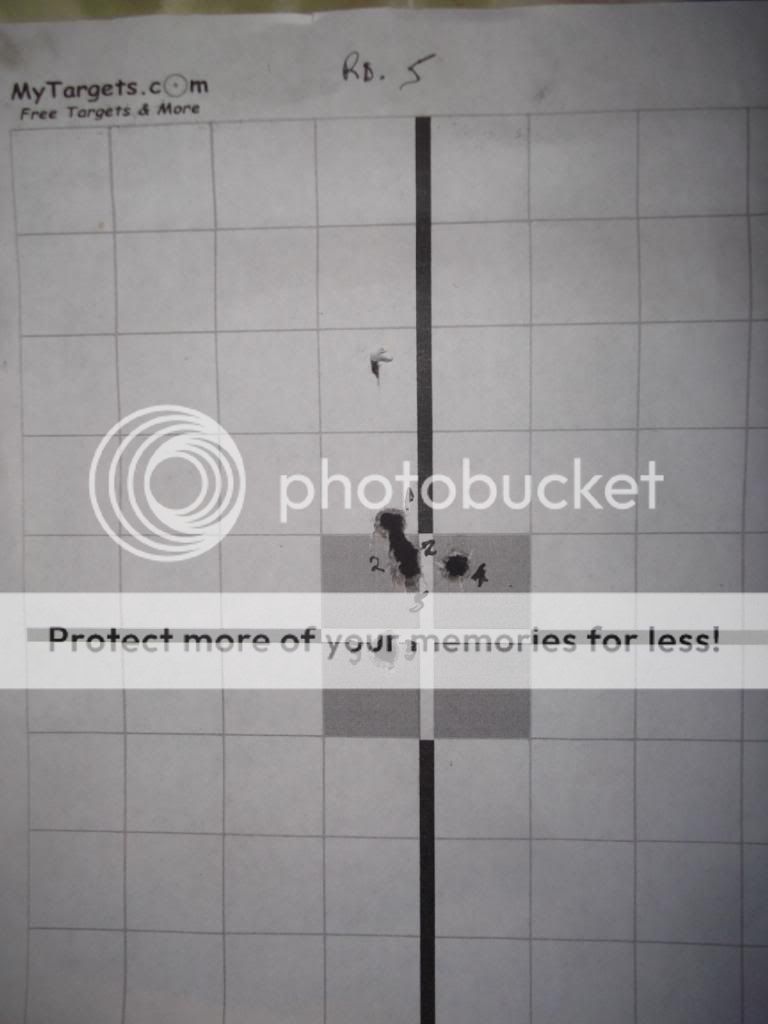

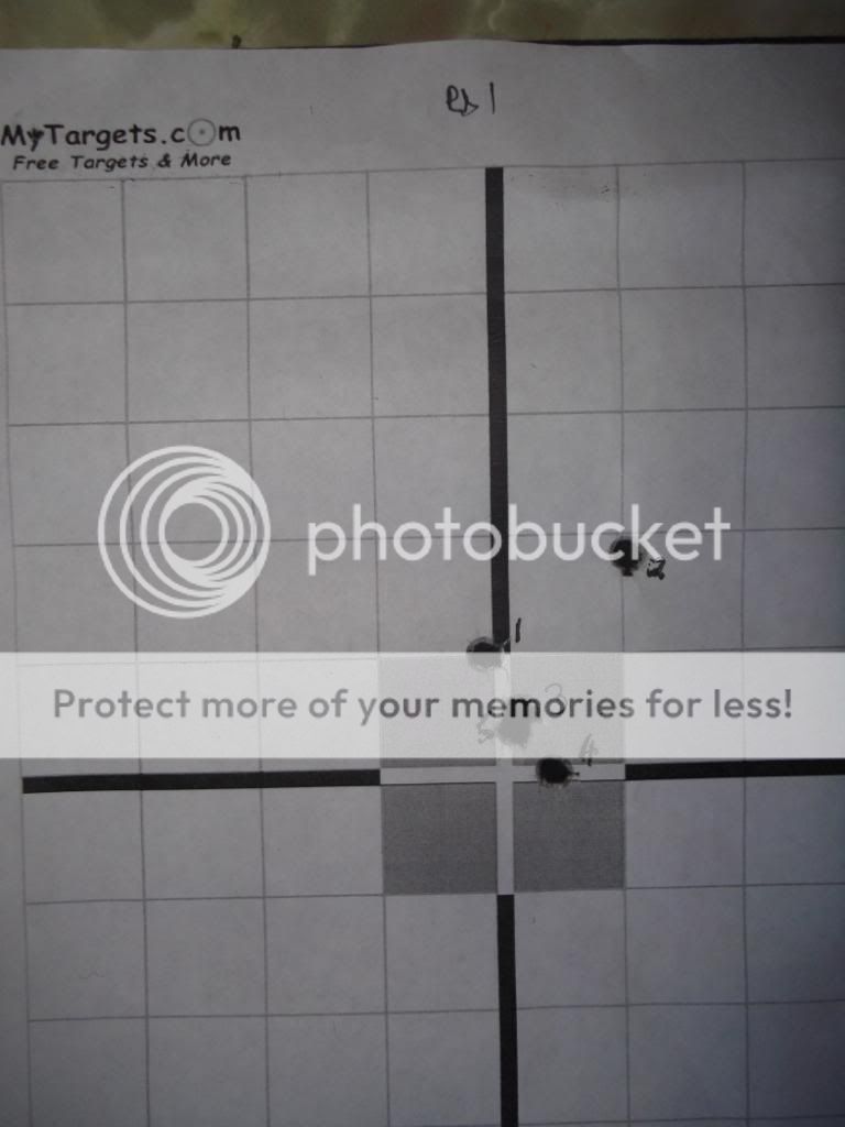

NEW TEST DATA FOR THAT F$%^&N FLYER
This is a follow on from my last little exercise in futility.
The gun is the same as is the ammo, Federal 150 soft point, range about 75 yds prone, gas off.
I'm still in pursuit of ammo ( for continuity, and I still cant find any H4895 )
The weather today was less than ideal, with a 30/40 kmh breeze blowing left to right across the range.
Approx 23 C.
I decided to start the test with a warm barrel and I needed to check the zero anyway so 15 rounds went thru her first
First 2 rounds were off paper to the right then I got her sorted.
This time around I picked one mag, not the best or the worst, and fired off one mag at all 5 targets.
This time I kept track of the sequence of shots on each target :)
Target 1 is the first round out of each reload, target 2 is the second round etc etc.
The numbers on each target are the order of arrival.
With the barrel being warm to start the test, and being kept at about the same temp throughout, there seems to be more consistency, though vertical stringing is apparent in some groups.
As for group 4, this came as a complete surprise after previous results, and yes I am framing it :)

Looking at yesterdays targets proves that there is such a thing as the chaos theory. Apart from a bit of vertical stringing there is no discernible pattern at all.
Meantime I'll just keep trying out different stuff, including alternative stock.
And the 4th group...........Yeah that made me smile, no idea how it happened. just hope it happens again ....and again :)
