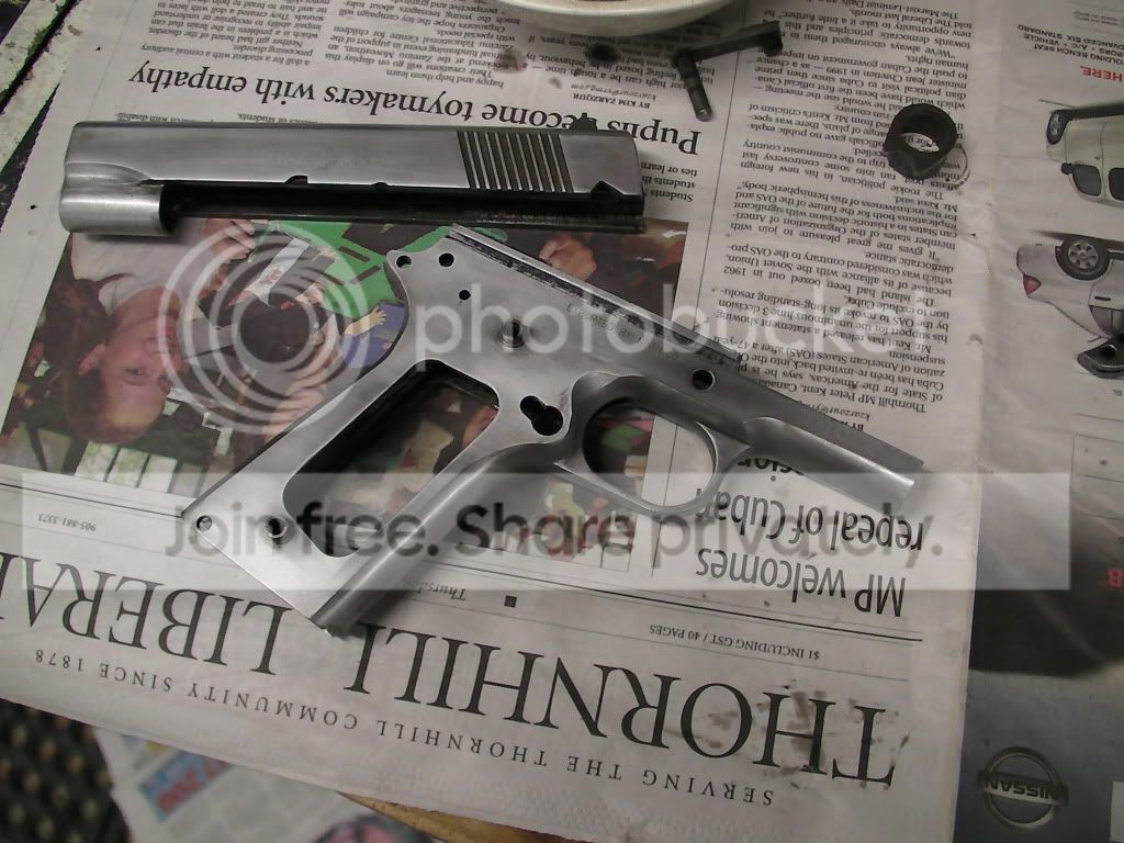

I detail stipped the gun, and save the springs, placed all the components in a bath of white vinegar to strip the finish off. Within 5 minutes, the finish turned a bright orange, and I was able to wipe the finish off with paper towel. Next I put the parts in a water bath to wash off the excess vinegar, and was left with a rough steel finish.
I spent a few hours wet-sanding the parts down with 400 grit sandpaper, and I was left with a nice, clean looking 1911.

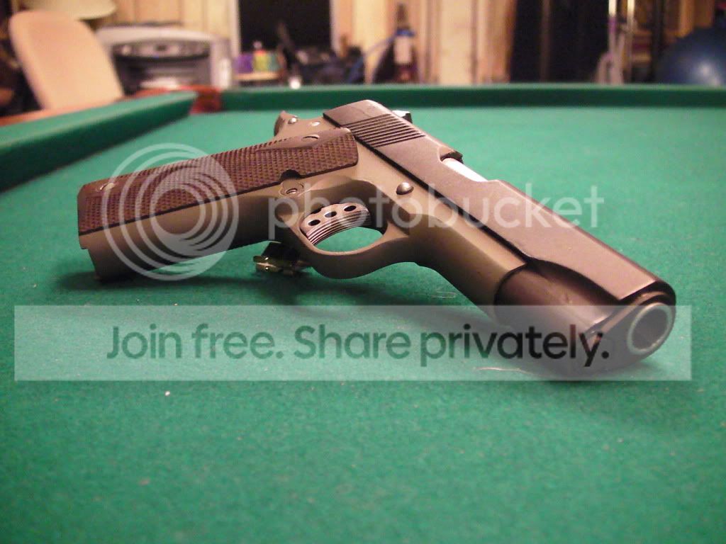

Finally, I decided to paint the gun. I applied a grey primer on all of the visible surfaces (including what shows when the slide is back). I left the barrel, rear sight, and trigger stainless in the hopes of providing an interesting set of colours.
I got an OD green spraypaint for the frame, grip safety, trigger housing, safety, hammer, mag release, and slide release. I used a matte black for the slide, extractor, firing pin cover, bushing, and the button cover for the slide spring. I know that with it being spraypaint, it will probably wear off pretty fast, but as it was my first time, I wanted to learn the basics of what to do and what not to do before using somthing like guncoat or duracoat.
I took it to the range last weekend, and started with mags loaded with two rounds. (In case I did a bad trigger job) Everything went perfectly, and there were no problems. Once I gained confidence in the trigger job, I began using to full mags, and still no problems. The trigger was holding up perfectly, and I noticed a big increase in my accuracy, holding a 4-6 inch group at 15 meters.
Needless to say I was and am still very pleased that this was a successful project.
Here is the finished product of all my hard work.
Let me know what you think I can do to improve it or my methods.

As for the serial number, it was actually filled in by the painting process at the time these pictures were taken(Before it left the house to go to the range). They were still visible, just barely, although you can not see it in these pictures. I have since etched them carefully back out with a small knife, in order to leave the paint intact but have the original serial number etching visible. I did not know of a way to not have them fill in as I was painting, so I continued on and fixed it after it dried sufficiently.
I still hope to find a better process for the next time I do this though.

While painting engine blocks I usually coat any gasket surface with white grease, paint, allow to dry, and wipe the paint/grease away to an untouched finish. You could try that if you ever do round two.
I will keep that in mind, thanks.
I do not have terribly high hopes for the durability of this finish, but I do not have a problem with that. It was a good learning project, and now I know what to do when I try it with a proper firearms paint.
