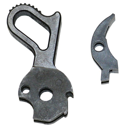

Question for Hitzy: How can you tell that a part is MIM and not cast/forged/etc? I'm sure I'm not the only curious one.
You can tell by the surface finish, there will be casting lines, or for MIM pin marks. Here is an example, look for the little round indented pin marks in the lower part of the hammer.
Ah, I see. Thank you.
I've not detail stripped either of my pistols, but at least I know what to look for when I do.
MIM and cast parts are not as crappy anymore though...at least with US/Philippines parts. I don't have any concerns with properly made MIM/cast stuff. I question the quality of Chinese MIM/casting processes though as I don't think they have the proper QC in place to ensure a decent product. Same with Chinese aluminium...not up to par with the rest of the world yet.
