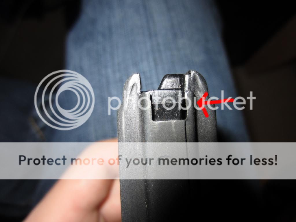

This pic shows the side that needs to be taken down.

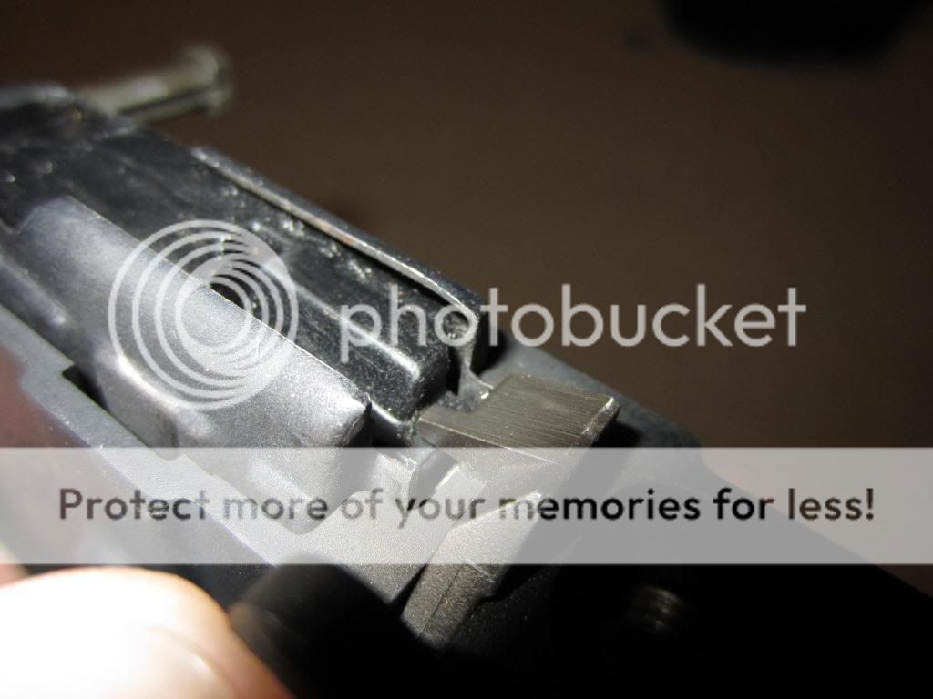

Here's a picture of the mag inserted without the modification, the metal pushes upwards on the slide release not allowing it to be depressed.

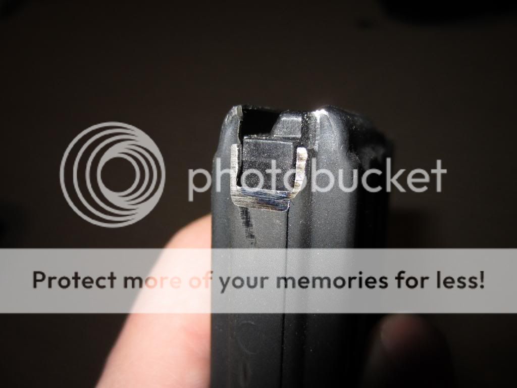

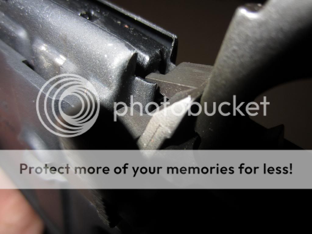

here's another rough grind job as I have a very fine grinding wheel on order from HH

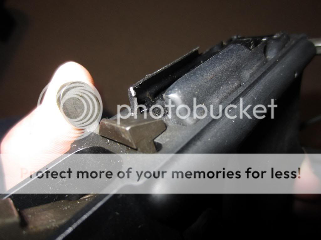

Here's how a mag should be able to operate when inserted
