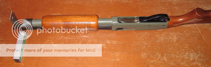

Thanks for posting Rem3200, some barrels do indeed fit, as far as cant can you balance your receiver upside down on a flat surface, resting on the flat milled area on top of the receiver, and then look at the front sight in relation to that same flat surface?
Here's a picture of one of my Rem 870's with a 14 " HP9 barrel. I was able to rest it right on the table because it only had a small bead sight where as you will have to put yours on a block to clear the rifle sights...
Not like that ... :D you got the dog holding it up straight.
Really, the towel doesn't help hold the receiver square either. :) Keep in mind you have the clamp holding it together too. Maybe remove the clamp and then set the receiver square on a block of wood, for instance.
... and by looking at the frontal view in your photo, I think yours is crocked too.
Hey Can-down ... LOL :) nothing like squaring off an American shotgun and a crocked Chinese barrel with a Japanese square. Now that's accuracy. :p
Not like that ... you got the dog holding it up straight.
Really, the towel doesn't help hold the receiver square either. Keep in mind you have the clamp holding it together too. Maybe remove the clamp and then set the receiver square on a block of wood, for instance.
Left the dog pic in there for that exact comment as he does have a way of getting his nose stuck in at most opportuities. That would be " Parker "
Thought the same thing that the clamp may take out some if not all misalignment but not going to disassemble for a pic. The photo is deceiving as the extra thickness of the mag extension makes it look offset from the barrel. I can eye from the bore back and looks true to me.
For the sake of the original poster all Remington pieces I put into it worked fine for me.
