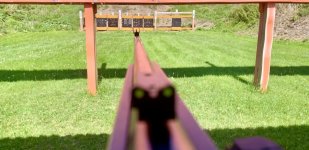

Got it and installed it. I have not yet sighted it in, but what an improvement in visibility; not only for the rear sight, but a wide enough knotch with great contrast against the front blade. This is the Marlin sight set, and the dovetail fits; the screw secures the sight. Perfect for a short, quick truck-gun. View attachment 1128635View attachment 1128636

My front sight appears to be one piece of milled steel; ramp and blade; no dovetail. The Marlin sights that I bought were on for $33.00 at Bulseye came with a fiberoptic dovetailed front sight. 3/8 also. I am considering filing the front sight level, then hand cutting a dovetail, if need be. Presently, the improved sight visibility is very good.
Your sight looks identical to mine. It’s a screw into a threaded plate that slides into the dove tail
Very similar; middle screw is elevation, rear screw jams the sight dovetail into the sight body. Easier to install than the old one was to remove.

The dovetail would have fit I think, but the sight would have been way too low. I ended up filing the sight blade off of the ramp, then cuttin a dovetail with hacksaw and needle files. Took about an hour. I had to peen dovetail flanges on the barrel to make sure that the front sight ramp can be tightened in place. Turned out nice! Using the ramp allowed me to use the sight hood too!

Tinybear, I also had the front sight fall off. I peened the dovetail for the front sight as well; got it to where I had to tap the dovetail nut into the dovetail slot. Short sight radius was a bit tough to get windage zeroed, but I love the elevation screw. I did not have my right shooting glasses, but it is on target. The stock JW mag is starting to feed better.
Bottom line, much improved sight visibility, much smaller, tighter groups.

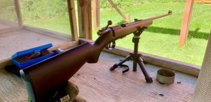

I shot this at 100 yards (from the bench w/ a 4x scope), it's an 8 inch gong. The JW-13 seems to really like the subsonic 60 grain bullet.
I tried to find some of this ammo locally (within 60 km), not a single box, I did find a few far away dealers with it still in stock for 17-20 bucks a box + shipping. I can live without it.
