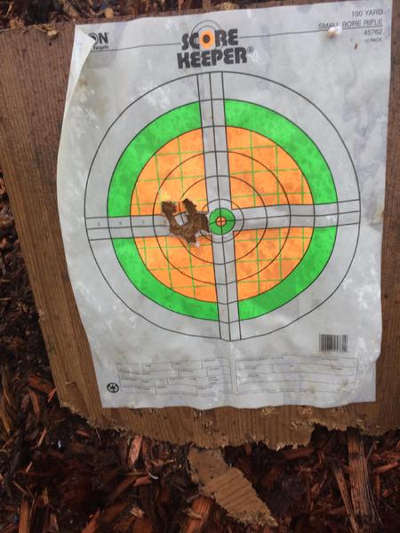

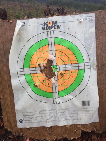

UPDATE : So after doing some light sanding on the serial numbers on the piston (which was causing some drag) and a few hairs of metal, one in the receiver and one in the area where to piston protrudes through to the op rod.. I took the gun out to my range again for a second chance. No jams, flawless cycling, no problems. one quick elevation adjustment after the first group and you can see what happened for your self. I was shooting chinese 123grain FMJ mil-surp. there was a little wind and a fair amount of rain at approx 25 yards. Shot from standing with a shooting stick. My next groups were shot casually and still not bad. Very pleased.norinco update.jpgnorinco update2.jpg
