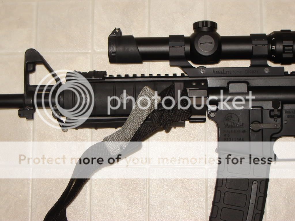

I had a Midwest free float rail on my Norc, you have to do the following:
Check Clear
Seperate upper and lower.
Remove handguards
Cut Delta Ring assembly off with a dremel (be gentle, excercise caution and don't do it in your reloading room - sparks)
Assemble handguard onto the rifle per the instructions
(one tip, you can use the carry handle or a pic rail accesory to make sure the rail is properly aligned - I used an Armalite scope mount)
20-30 minutes tops. It's almost like instant Tacti-Cool.
The continuous rail does give you more options for placement of optics, it seems to me if you don't have a continuous rail the glass is either too close or too far.

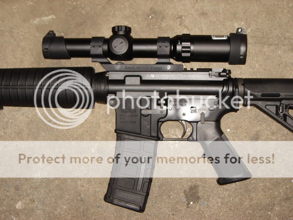

The Delta Ring is the device that holds the factory handguards on.
with Delta Ring
without Delta Ring
and that is a Norc Upper on an Armalite Lower.
I just checked the rail you're referring to - it's even easier, and the first continuous top rail I've seen on a non-float rail. Under normal circumstances these rails drop in to replace the handguards. This can be an issue with Norc M4's, the length of the handguards can be out of spec. You need to measure the distance between the inside of the Delta ring and the front handguard cap (measure carefully). Then find out the diameter of the front handguard cap on both your rifle and the rail. If they don't match you'll have to convince them to with a dremel. Frankly if the lenght is out the free float is easier.
