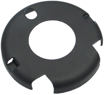

Almost any Free Float rail will fit hte Norinco, and most drop-ins will also fit IF you change out the handguard end-cap to a proper in-spec one.
To anyone that can help
Not 100% sure what the handguard end-cap is
(let me rephase that, if it has a specific name)
so i am not 100% sure what i am looking for. I have searched the dealers website, but again, i am not 100% sure what i am looking for
Can anyone help me out
You need one of these:
