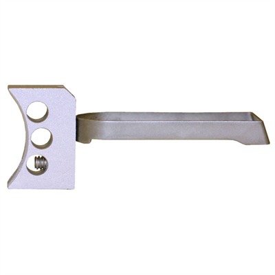

The guy in Reliable Gun was very skeptical about Norincos and it probably sounded funny when I said "sure, I can fit it myself" but he didn't laugh. The trigger was $40, it's a superb aluminum trigger with steel bow.

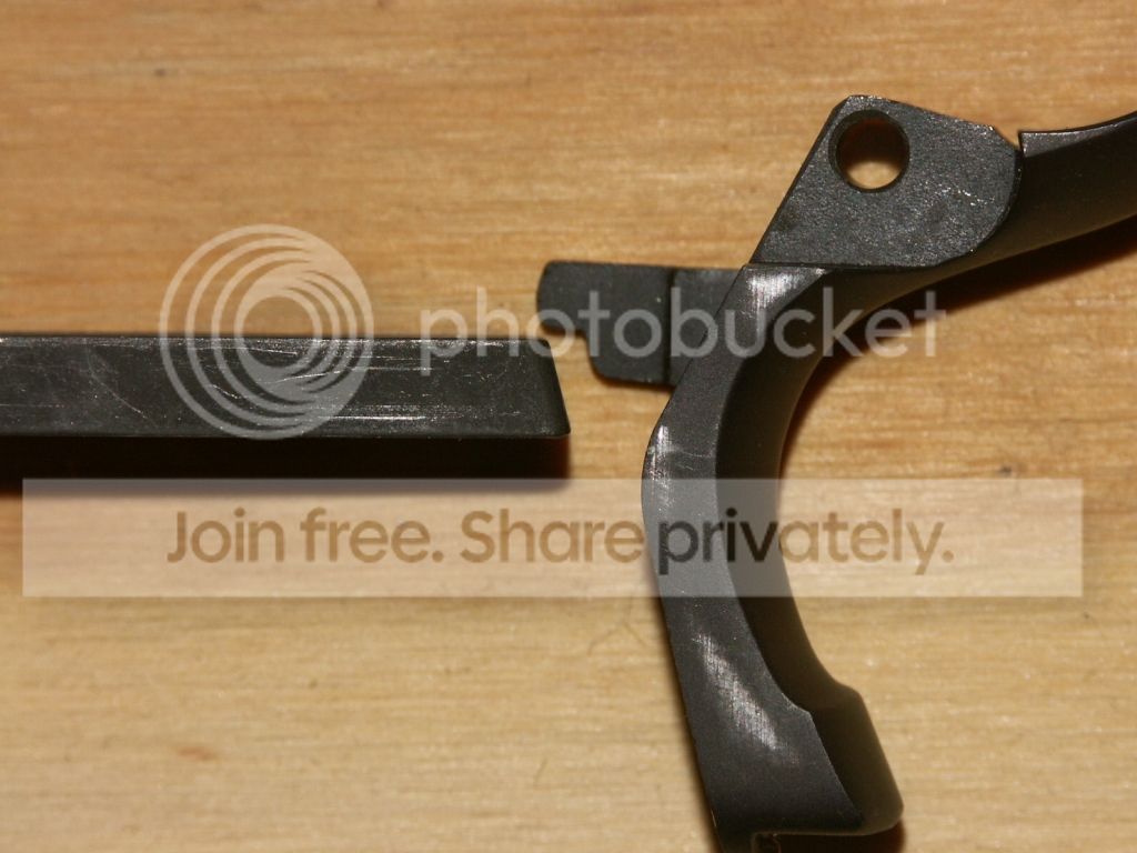

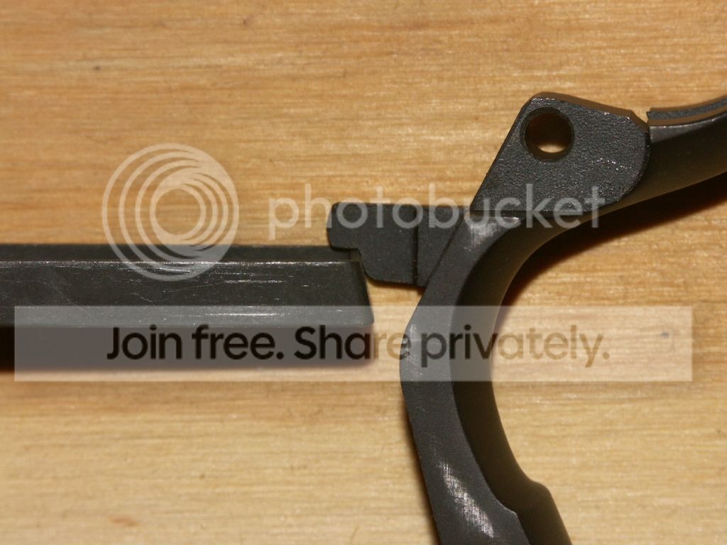

A week (or more) later I felt like I'm ready to continue the fight. I tested the trigger many times trying to understand what's wrong with it and came to the conclusion that it had something to do with the grip safety. I found a really good article on M1911 website (not sure if it's not against the rules to insert a link, the article name is "Wilson Combat Drop-In Grip Safety") which helped me to solve the problem. The new trigger bow was a tiny fraction of inch longer than the old one and as a result it didn't fit the grip safety well. Here are couple pictures with captions from another forum to illustrate what I am talking about (thanks to the author of the pictures Harwood Loomis!):
Grip safety arm must lift high enough to allow the trigger bow to slide under the upper, forward tab (at left in photo)
Trigger must be able to move back to this position without drag
I had to file the grip safety now, but it didn't take long and I was super happy that this problem was so easy to resolve (in contrast to my previous "adventures" with the gun).
