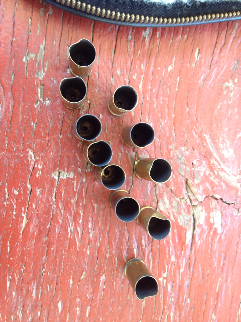

I have one; satin chrome finish on both the frame and the slide. Nork checkered black hard rubber grips; adjustable rear sight. It is a sharp looking pistol. Runs like a top on both factory and remington mags. I shot two boxes of factory ammo and 2-3000 rounds of home loads since. My accuracy loads are moderately light 200 gr. LSWC. It is accurate! The adjustable rear sight is a bit of a teaser to adjust. Like all 1911s you will get the odd piece of brass with the mouth crushed/dented. Small ejection port (most updated 1911 designs will have a lowered, enlarged ejection port). I have so much brass I don't worry about it.
