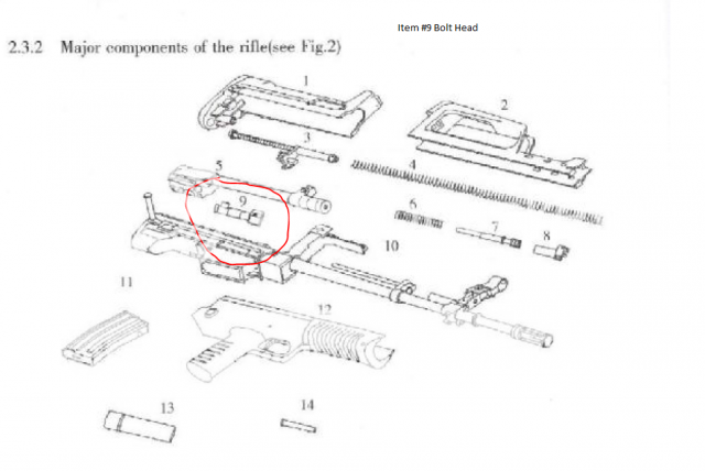

Can anyone direct me to where I can obtain a bolt-head (the part that houses the firing pin and extractor) for a Norinco Type 97 rifle. - see circled in attached image
I'm not actually sure if this is for sure the correct part in the picture since mine is missing from a newly acquired (used) rifle and I've never actually seen one, but I do know that whatever contains the firing pin and extractor is missing and there is an empty hole in the Bolt Body (item #5) where it should go

I sent the following e-mail to North Sylva;
I have a Norinco Type 97 rifle that is missing the bolt - the part that contains the firing pin and extractor.
The bolt (bolt head?) Item number 9 in picture (see link) was lost when it was removed and stored separate from the rifle
http://i116.photobucket.com/albums/o34/dukttape/Firearms/NorincoType97boltheada_zpsa57ac68d.png
I would really like to purchase a replacement bolt as without it, obviously, my rifle is completely useless!
Would you be able to supply a new or used bolt for this rifle, and if so, how much and when could it be made available?
Please and thank you!
and very quickly received the following response;
Hi John. I do have a bolt assembly liberated from a rifle we are using for parts (New), but here is the possible issue. The bolt is serialized to match the rifle.
In Canada, it doesn't matter about the serial number, as long as your rifle is serialized, but the bolt assembly may be specifically set up to match the specific rifle for headspace, and fits and clearances.
All that said, I have no problem selling you this bolt assembly (with firing pin and extractor), but I can't give any guarantee that it will be a drop in part, or that it will function properly in your rifle. I can suggest that you send it in to us and our smith can install it, check it, and test fire it.
Please advise,
Sincerely,
George Wedge
