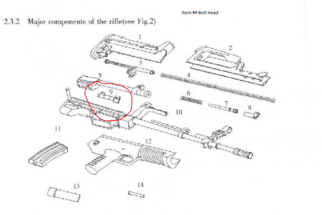

I have a Norinco Type 97 rifle that is missing the bolt - the part that contains the firing pin and extractor.
The bolt (bolt head?) Item number 9 in picture (see link) was lost when it was removed and stored separate from the rifle
http://i116.photobucket.com/albums/o34/dukttape/Firearms/NorincoType97boltheada_zpsa57ac68d.png
I would really like to purchase a replacement bolt as without it, obviously, my rifle is completely useless!
Would you be able to supply a new or used bolt for this rifle, and if so, how much and when could it be made available?
Please and thank you!

Hi John. I do have a bolt assembly liberated from a rifle we are using for parts (New), but here is the possible issue. The bolt is serialized to match the rifle.
In Canada, it doesn't matter about the serial number, as long as your rifle is serialized, but the bolt assembly may be specifically set up to match the specific rifle for headspace, and fits and clearances.
All that said, I have no problem selling you this bolt assembly (with firing pin and extractor), but I can't give any guarantee that it will be a drop in part, or that it will function properly in your rifle. I can suggest that you send it in to us and our smith can install it, check it, and test fire it.

Couple of things to check...
1. Headspace.
2. Engagement of locking lugs.
Best to check these prior to shooting this rifle, or any other rifle with a replaced bolt, for that matter.
