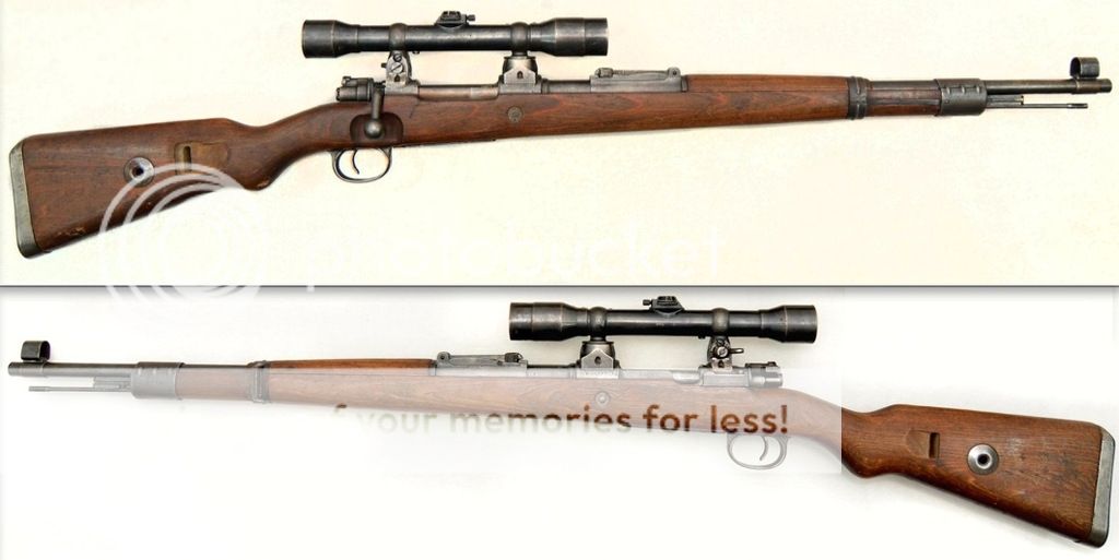

You maybe correct. Pretty sure it's been welded as I took a closer pic. You can still see the threads from the inside.
I may just keep as is or get it D&T for claw mount with original or replica mount and 4x optic of the era.
Not sure what the Norwegians used for surplus K98k sniper variants but found a few leads online.
Just out of curiosity.. Could the welds be drilled out? Thx.
OP, you can see on the pics how small the heated area is and that is the thinnest part of the receiver. Those welds, depending on what hardness of wire or rod was used should be able to be drilled out and re tapped. Make sure you have the proper equipment to do that job and that everything is properly centered.
I would start with a properly ground center drill. A regular drill bit will move off center when pressure is applied. Get a competent gunsmith to drill out and retap those holes. It will be money well spent and IMHO that rifle is worth the effort and cost. A sniper clone, if done properly, can be quite valuable.
