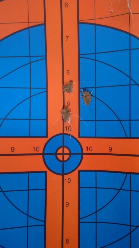

Well I finally loaded up some of the new rounds. I found 93.4 Gr of retumbo to work best with my rifle. Here is a 3 shot group at 200M caliber is 300 RUM.
