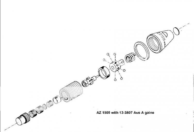

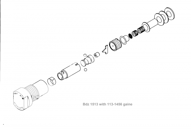

Pretty well all German 20mm ammunition whether Oerlikon FF, MG151/20, Flak 30/38 had either a nose or base fuze. The exceptions were some of the AP and API projectiles.
The fuzes were quite sophisticated with bore safety built in and in some cases a self destruct facility.
Attached are examples of a nose and a base fuze.
Regards
TonyE
Regards
TonyE
