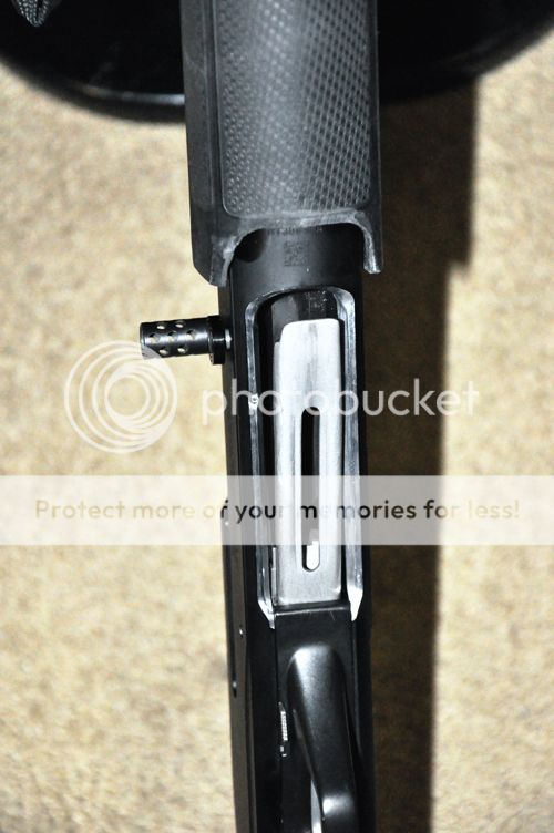

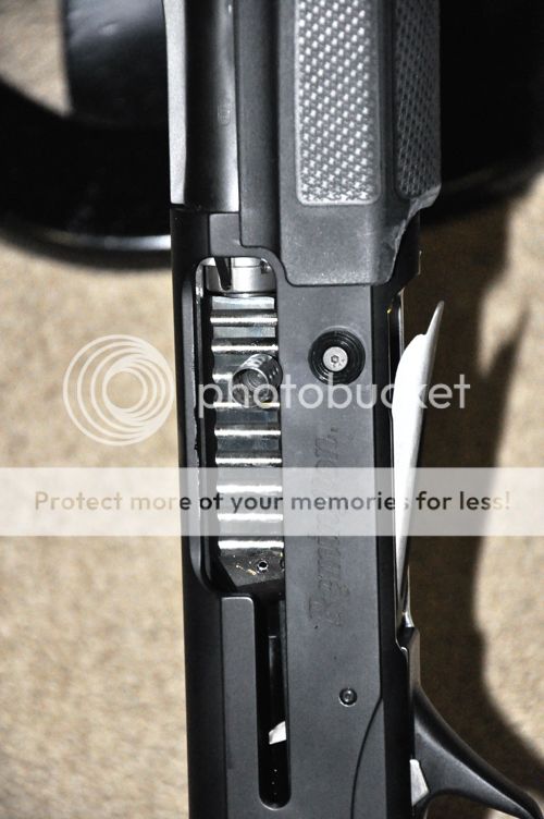

I have the 22 inch tactical model and legally can get 6 + 1 because the gun is marked for 3 inch shells despite actually being chambered for 3-1/2. Most of my fellow shooters here in Texas get the 26 inch model and then upgrade it with all the so called tactical features. When down here I have the extension that came with the tactical and then a two round mini extension on that for 10 + 1. It works flawlessly. I also had some mods made that help to make this a fine gun for 3Gun. One of the changes replaced the lifter with an extended one that is easier on the thumb during high speed reloads. It's certainly one of the most popular competition guns available.
Hercster, what brand of extended lifter did you acquire?
I had my work done by Benny Hill who has a shop here in Corpus Christi that does work for most competition shooters. Initially I believe that they "welded" up the modified lifter. Now it looks to me that he has them fabricated from scratch. It's longer and squared at the chamber end as compared to the "V" on the OEM. That "V" and the extra space between it and the end of the loading port can be a nasty trap for your thumb. Benny also machines the loading port to eliminate sharp edges. He also cuts an angle into the foregrip to eliminate the 90 deg end that catches on your hand when doing some reloads. He lightened the bolt as part of the package. With those changes and the addition of the "tactical" parts, the VM is a very good gaming gun. Here are a couple of pictures that will help illustrate the changes. I'm told there are Canadian smiths that do similar work.
The beauty of the VM is that just a few changes make it close to as good functionally as other brands at less cost. I suggest that shooters consider good extended chokes. They are VM specific. I bought Trulocks.

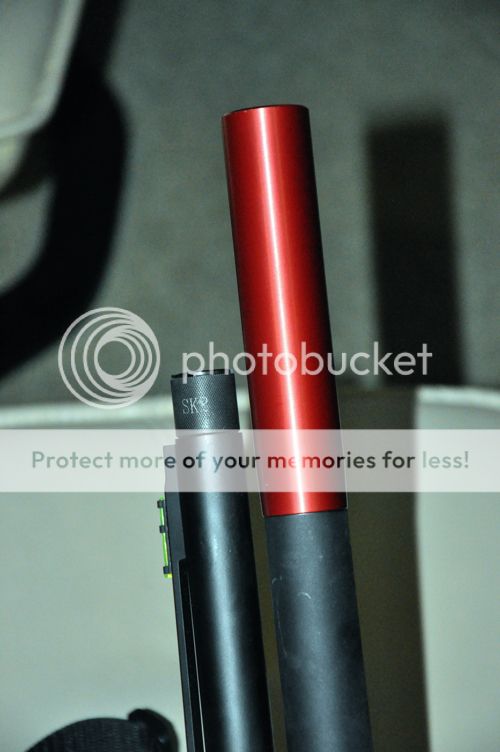

There is only one disadvantage to the Tactical if that's what you want and that is the chamber marking at 3 inch which will cost you a round of 2-3/4. This isn't all that relevant for a gun to be used in Canada. I got the same capacity as a 26 (ten +1) by adding a plus 2 cap. Here's what it looks like. I have a plus 1 as well.
The only issue with the extension going forward of the muzzle is that it gets a lot of powder residue. I make it easier to clean by smearing on a layer of frog lube paste before I shoot.
