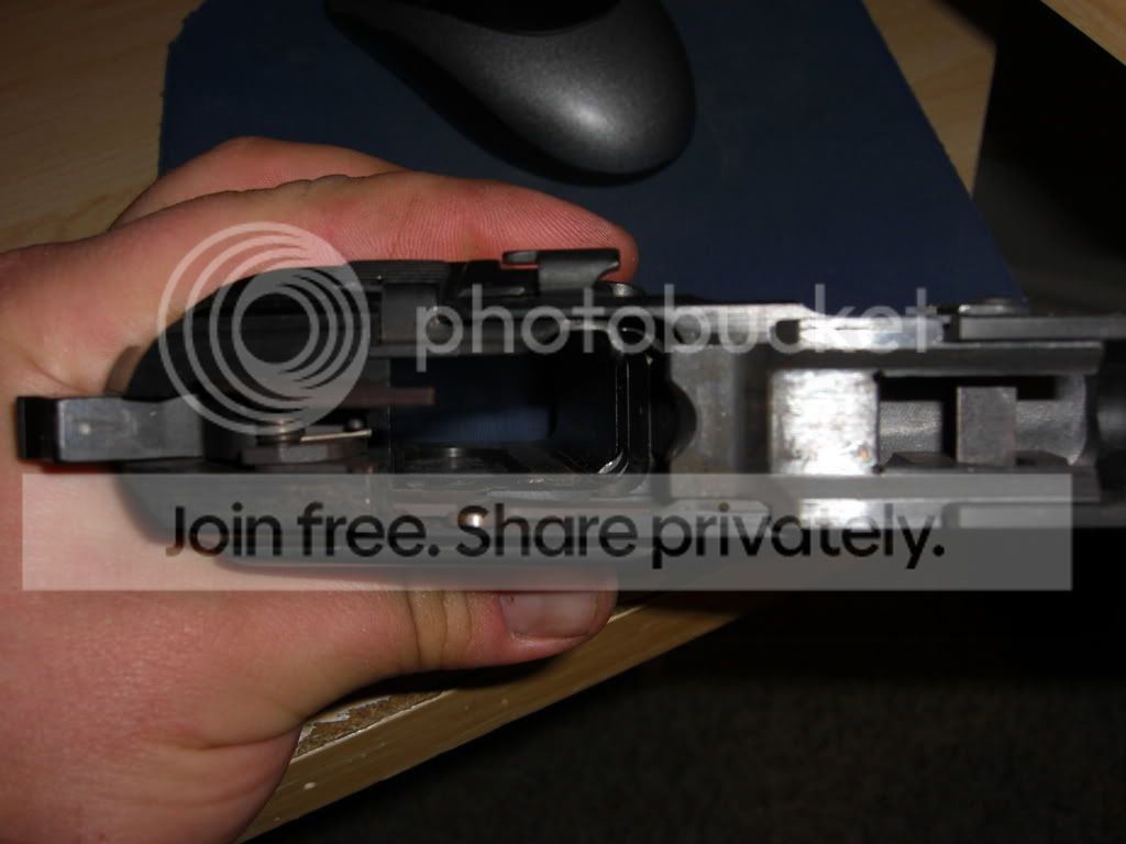

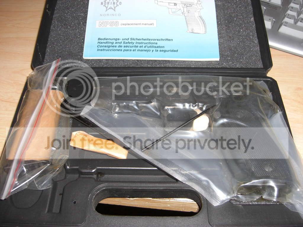

Everything came sealed in plastic bags with a thin coat of heavy oil. Gun, 2 mags, cleaning rod/screwdriver, manual. Also a hunk of paper I almost pitched but decided to open. Inside were a spare trigger bar spring a mag release spring. Good thing I opened it.:cool:(BTW it uses the old style trigger bar spring) As well as some sortal picky thing ?

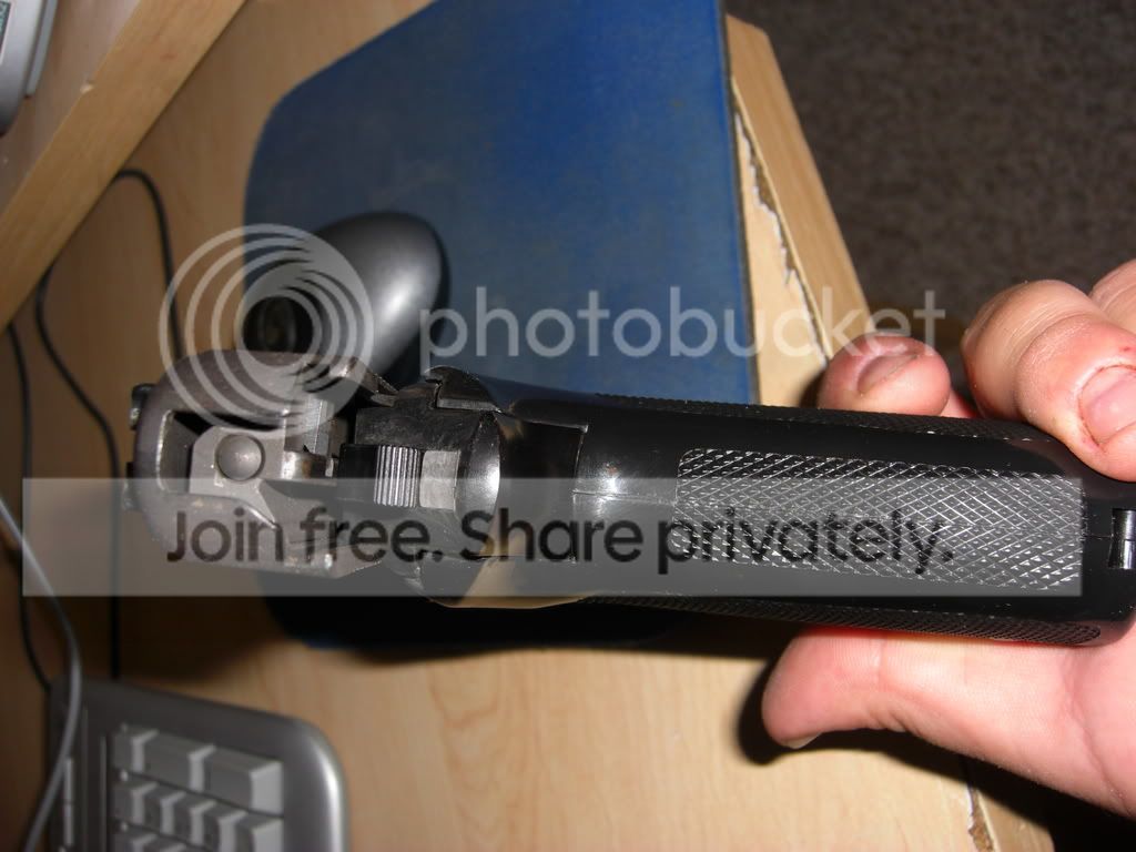

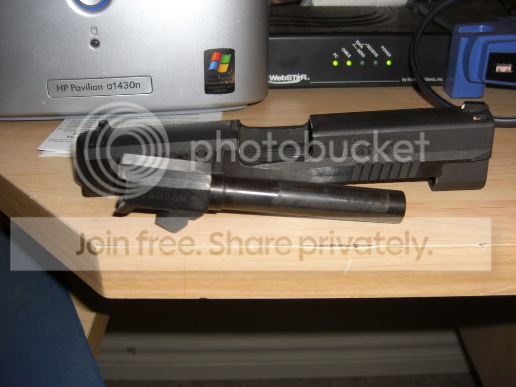

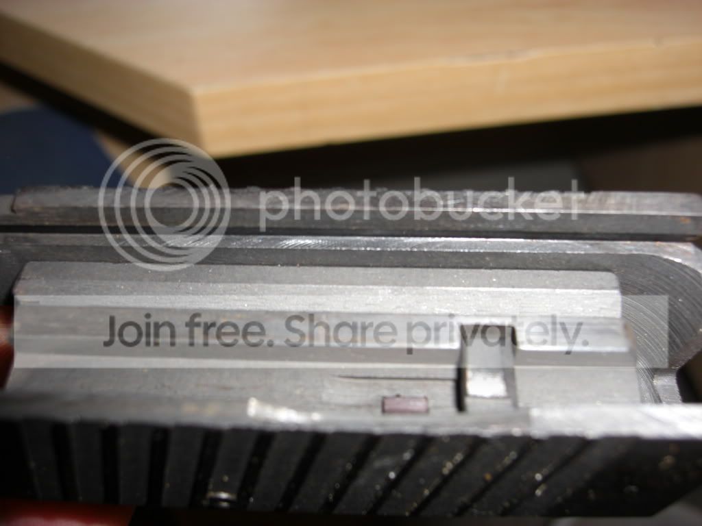

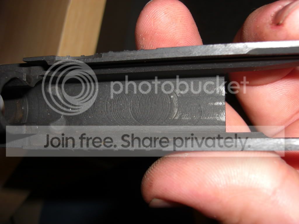

Pulled it appart cleaned everything up and started looking for the tell tale rinco machining marks. Total for the count was 2! The sides of the rear sight and inside the top of the slide. I was quite amazed.
Looking through the sights, the white dots are more of a yellowish tinge but I could care less. I don't even notice the dots when Im shooting it.

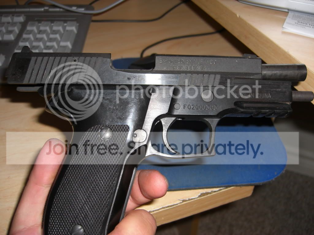

If there is one thing I hate it is plastic. (Glock :stirthepot2:) The grips are an abortion. Hard slippery plastic. I didn't even bother trying to shoot it with them. The day after it showed up I was off to the store for a set of Hogues.
The Hogues fit but needed to be modified slightly on the inside. The guide for the spring on the backstrap is slightly higher than on a real Sig (about 1/16'' or so) quick work with a sharp knife and I was in business. Now she feel great.

So after 500rds there is only some wear on the outside of the barrel. The aluminium frame shows no wear what so ever. Even on the slide rails.

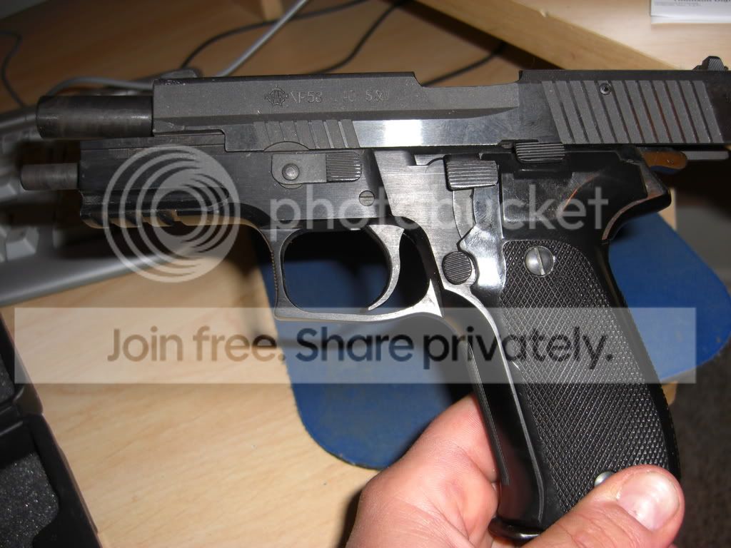

sorry for bumping an old thread. I am interested in this baby. I see some reddish spots on the inside. Is it rust? Did you give it a nice and thorough wash before you shot her? How do you lubricate her? Do you use a lot of oil? Grease on the slide?
Its not rust. Its just the colour of the metal after heatreat. Kind of a really deep red/brown colour. Light coat of oil on moving parts/surfaces.

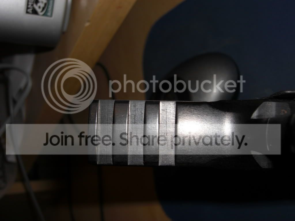

Can you take some more pics of the barrel? Nork used a 2 piece unit for a while in the 228/226 clones, just wondering if this one is the same.
